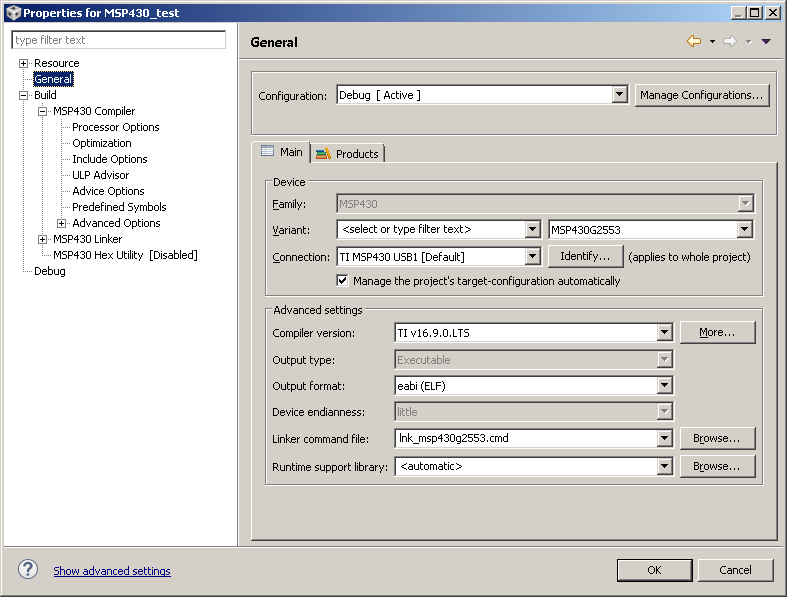

Hi Everybody,
I have msp430g2553 Microcontroller and i'm using CCS6.1.3
when i try to build the program i wrote it shows me the following error:
error #10099-D: program will not fit into available memory.  placement with alignment fails for section ".text" size 0x16b2
I understand that the section .text is the code i wrote and  0x16b2 (5810) is the size in bits?
The msp430g2553, the RAM  is 0.5KB and Non-volatile Memory is 16KB
so ,if i'm not mistaken about what i wrote, from that i can conclude that there's still memory left.
i used Optimizer Assistant but all levels shows red.
in the linker > Advanced Options > Runtime Environment i choose ROM and RAM  in initialization model but nothing is working
so, i have two questions:
1. does ccs limit the code size? if so, how can i change/disable it?
2. what other ways should i check to solve this problem.
Thank you all.
  • For MSP430, the linker expresses all sizes in bytes (8 bit units).
    Please show us the linker map file. You can generate the linker map file with the --map_file linker option.

  • Joe Shoshana said:
    Here's the test.map generated in the debug folder:
    <snip>
    MEMORY CONFIGURATION
    name origin length used unused attr fill
    <snip>
    RAM 00000200 00000100 00000088 00000078 RWIX
    <snip>
    FLASH 0000f800 000007de 00000040 0000079e RWIX
    The map file shows a device with 256 bytes of RAM and 2 Kbytes of FLASH has been selected, which is why the linker reports that your program will not fit into the available memory.
    When you create a project in CCS, and select the MSP430G2553 device, CCS should automatically add a linker command file named lnk_msp430g2553.cmd to the project where the lnk_msp430g2553.cmd specifies 512 bytes of RAM and 16 Kbytes of FLASH.
    Can you check the CCS project properties to ensure a MSP430G2553 device and lnk_msp430g2553.cmd linker command file have been selected:
  • thank you for the reply
    i've check if MSP430G2553 and lnk_msp430g2553.cmd has been selected. and they are, see below
    The screen shot shows a MSP430G2253 and lnk_msp430g2253.cmd have been selected, rather than MSP430G2553 and lnk_msp430g2553.cmd
  • thank you for your help
    i didn't see the little mistake, now after checking with the optimizer and the memory allocation it looks very good
    thank you again for your help
