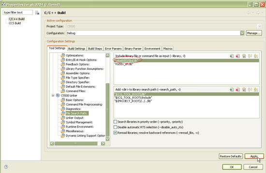

Can one of you guys take a look at the attached sample project and tell me why it can't find the .lib file?

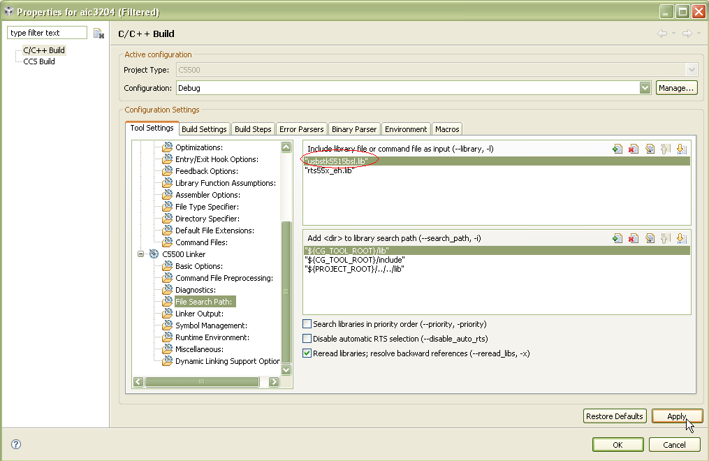

    It's because it is looking for "usbstk5515bsl.lib" in one of the defined library search paths and can't find it. Either have the full path to the library when specified in the -l option, or add the path to the lib in the -i option or simply remove the reference altogether since you already have the library physically added to your project. Any one of the three options will work (I'd simply remove it from the -l option completely since you have the library already added to the project)

    An important paramter to any compiler or linker and one that causes the most confusion especially when using it with an IDE is the configuration of the search paths for the include and library files. Therefore in 99% of the cases where a file is not found there is an incorrect setting to either the compiler (Build Properties --> Include Options) or the linker (Build Options --> File Search Path) - the remaining 1% is due to other special conditions like no permissions to read a directory, network errors in case of remote directories, etc.
    When using IDEs, the major confusion comes from the fact that sometimes the project contains all the required files to build, but the compiler or linker cannot "see" them due to misconfiguration in the properties above. In Eclipse this becomes a bit easier to happen since the project manager acts as a File Manager, therefore any files or folders that are located in the project directory are displayed in the Projects View, giving the impression the compiler/linker are also able to look for them - the tools do not try to guess to where the headers/libraries could be in your file system. (correction) In CCSv4, any libraries or include files that are in the project directory are automatically included in the build, but any libraries that are specified in the build options take precedence over the ones automatically included!
    In your specific case that's exactly what is happening: although you copied the library <usbstk5515bsl.lib> to your project folder, the linker needs to be made aware of that. In the linker search path you have to include the project directory itself, described by the internal variable ${PROJECT_ROOT} is also being told there is another library of the same name but in an invalid directory, therefore throwing the error.
    Hope this helps,
    Rafael

  • Actually it does automatically find it at the root of the project. It also finds the one in the ../include folder. It just doesn't find the library mentioned in the build options. So it finds 2 out of 3.

    I corrected my post above; CCSv4 automatically picks the libraries and include files that are located in the project directory - therefore there is no need to specify the {PROJECT_ROOT} in the build options but only fix the path to point to a valid directory.
