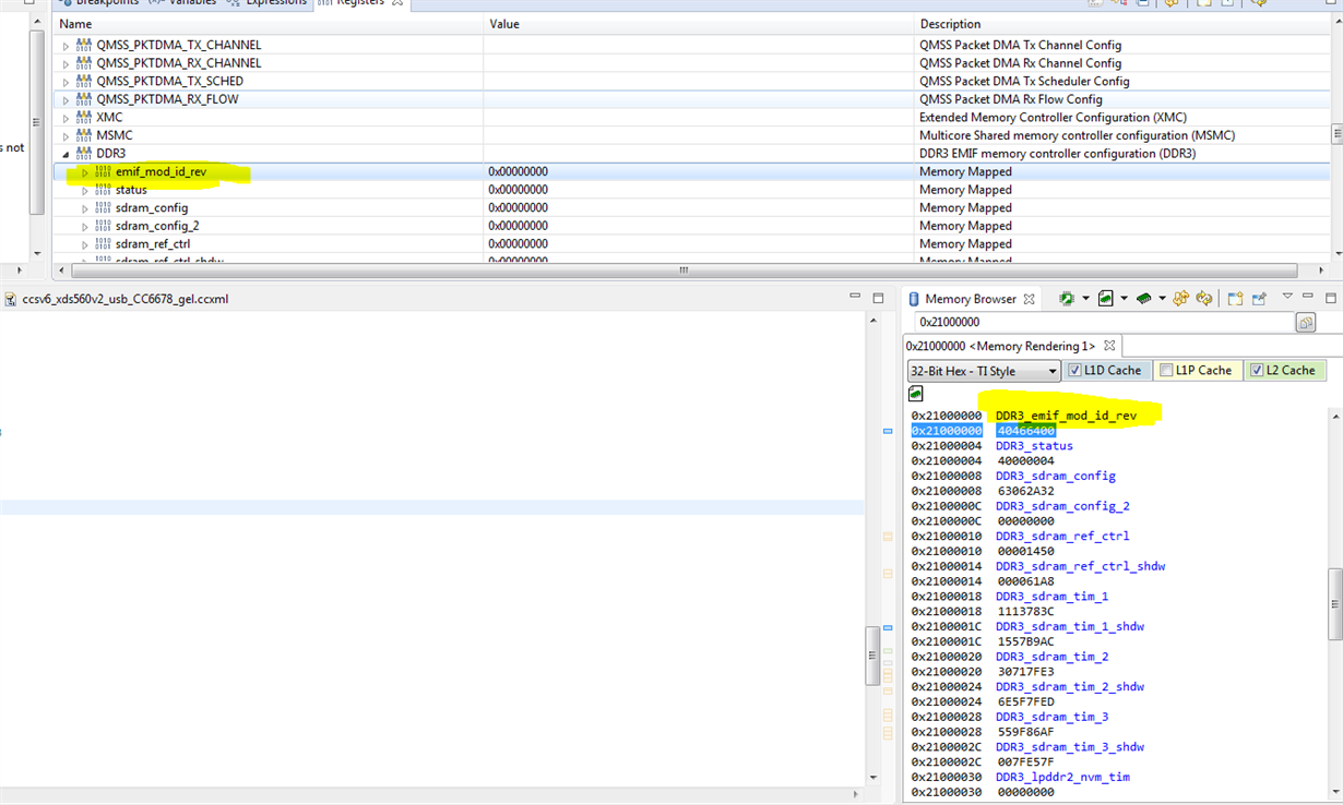

CCS/TMS320C6678: Discrepancy between DDR3 EMIF Memory Control Registers viewer, and Memory Browser
Part Number: TMS320C6678
There is a discrepancy between DDR3 EMIF Memory Control Registers viewer, and Memory Browser, but for the other registers it looks fine. For example, the MSMC and HYPERLINK registers between DDR3 EMIF register are good.
I'm running CCv6 version: 6.2.0.00050
C6678.xml file shows the correct starting base address.
 <instance href="../Modules/Keystone/ddr_emif.xml" id="DDR3" xml="ddr_emif.xml" xmlpath="../Modules/Keystone/" HW_version="TMS320C6678" description="DDR3 EMIF memory controller configuration (DDR3)" requestor="TMS320C6678" baseaddr="0x21000000" endaddr="0x210001FF" size="0x0200" accessnumbytes="4" permissions="p" />
    Thanks for reporting this.
    The discrepancy between the two is due to the fact the Registers view shows the address in Physical memory space, while your Memory Browser is configured to show it from a CPU perspective. The detailed explanation is shown in the thread below:
    e2e.ti.com/.../151934
    Therefore, the ultimate fix is to adjust the addresses in the device XML file - I sent this thread to the appropriate groups to comment further on the schedules for this to be fixed.

  • Hi Desouza,
    The information you have provided was a good introduction. I modified the xml file successfully by making the base address to 36 bits.

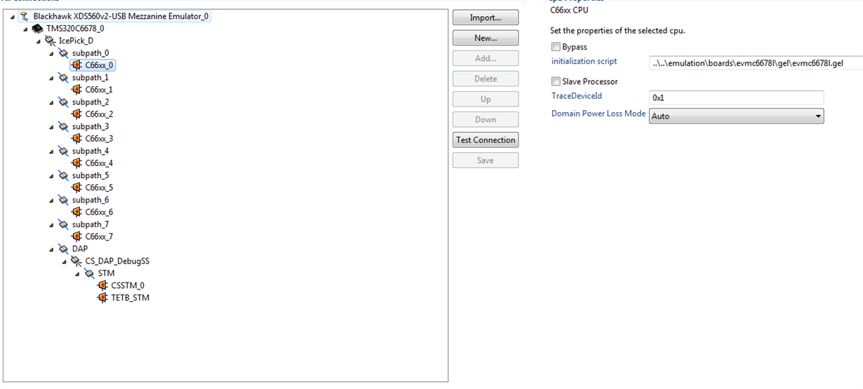

    - evmc6678l.gel -> xmc_setup() maps the ddr emif registers <C:\ti\ccsv6\ccs_base\emulation\boards\evmc6678l\gel>
    - C6678.xml needs edit to fix issue when using gel above <C:\ti\ccsv6\ccs_base\common\targetdb\devices>
