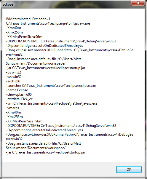

I'm seeing CCS 4 crash when I try to start debugging the example applciations for my LM3S6965 evaluation board.
CCS Version 4.1.3.00034 (I also saw this crash with v 4.1.2.00027)
Host OS: Windows 7 Professional 64bit
TI board/Processor: LM3S6965 Evaluation Board
Process to reproduce crash:
1. Start up CCS and select my workspace with all the example projects for my eval board.
2. Select the Hello World application and click on the Debug button.
3. CCS switches to the Debug perspective and then shortly there after crashes with the dialog below
Note I can also reproduce the crash by right clicking on the target_config.ccxml file for the project selecting Debug As > Debug Session and then pressing Alt+c to connect, at which point CCS crashes.
