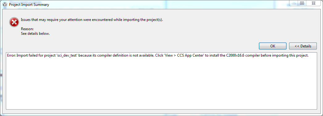

CCS: Getting error while importing project
I have got a CCS project from 3rd party. When I am importing this project in CCS6, I am getting this error.
I tried installing the latest C2000 compile via App Center but still getting the same error.
What do I need to do to fix this issue?

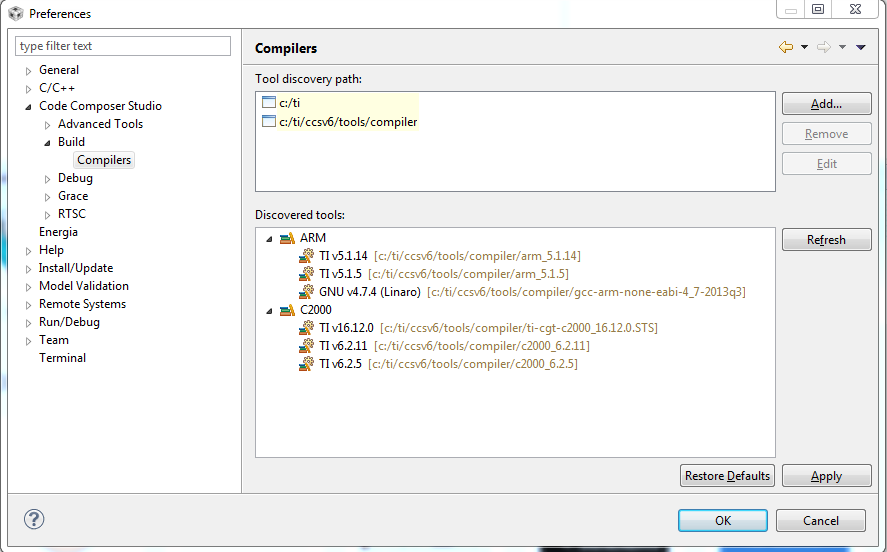

    You are on the right track; however, I want to be sure of what you actually installed via the App Center.
    Can you go to menu Window --> Preferences --> Code Composer Studio --> Build --> Compilers and see if you have a compiler 16.9 or 16.12 on the list? That would be critical to allow importing the project.
    Otherwise it would be interesting to get a copy of the example project and see what else could go wrong.

  • Hi Rafael,
    Thanks. I have installed the latest and it's showing 16.12. Is that issue?
    How to fix this issue?

  • Thanks Rafael. That was helpful. I uninstall the latest update and then install the 16.9.1 version.  After that when I try to import the project, I get error for different compiler version now (v16.6).
    I am wondering how it can have multiple versions. Also I can not find v16.6 in the TI Compile Updates list.
    Vivek Singh
  • Vivek,
    The problem is the same in this case - lack of compiler definitions in the specific CCS.
    My best guess is that the project has multiple build configurations (Debug/Release) that use different compilers.
    Interesting; I found the 16.6 compiler in the Install New Software list. Just make sure the checkboxes match what is shown below.
    Given you already installed 16.9.x, I suspect you will have to follow the procedure of uninstalling/reinstalling as you did before with 16.12.

  • Ok, thanks. I was able to install all the required update and import the project. Thank you for filing the enhancement. It's really needed :-).
