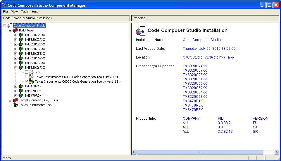

Hi Rafael,
I followed your suggestion to use the regsvr32 to register the .dll. Component Manager shows it as a blank option (see attached picture). I tried selecting it, CCS complained 'std.h' not found. I guess, the registration is not working at all.
One more related topic. How could I remove unwanted options in the list of selection, say this blank '<>' entry. I tried using "regsvr32 /u" could not remove it.
Thank you.
Chee-Beng
Something may have gone wrong during you installation. You may want to uninstall 7.0.3 and then reinstall it again. You should have a valid entry in component manager, instead of a blank description.
Chee-Beng Ang said:One more related topic. How could I remove unwanted options in the list of selection, say this blank '<>' entry. I tried using "regsvr32 /u" could not remove it.
You need to remove the associated registry entries. There is an executable called 'RemoveRegistryKeys.exe' in the folder of where you installed the CGT. However, removing the registry keys will prevent you from selecting that CGT in component manager (and using it from within the CCS IDE).
