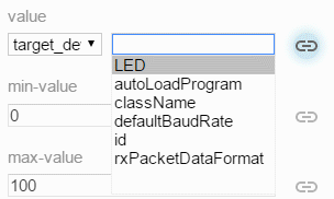

I am trying to use GUI Composer 2 (in the cloud) and am trying to select from Target Device parameters when binding a value to a widget - but they do not appear.  The list of parameters from the target device is not updated based on the program loaded into the device.  How can I update the list of Target Device parameters to make them available for selection? Or, how can this be achieved in Java Script?  Is there any documentation available - or a sample for this?

    To see the list of available binding terms, select the property you want to bind to, click the  button to enable binding, select target_device (the default) from the drop-down list of the left-hand field, then click in the box to the right of this and hit ctrl-space to see the list of bindable values:

  • Hi Brian,
    Thanks for your assistance.  I tried what you suggested and I am now able to see the parameters.  Much appreciated.  Regards, Timothy

    When binding a widget to a variable, you would need to first click on chain link icon beside the edit box, this action would resize the edit box and show a combo box that defaults to target_device (maybe you are already doing this, but just in case). You would then enter the global variable name.
