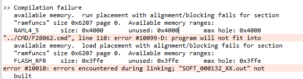

Bad luck, there is not enough memory available and the linker tells me it now requires 3 times the memory required previously (using source code of library version 135). So it does not fit in anymore ...

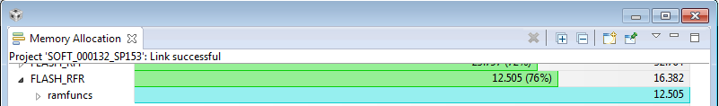

    Here is the memory usage of this section without any of the usb lib content in it :
    The remaining 3800 bytes free corresponds approximately to the space freed when switching from v135 (using sources, run from ram) to v151 (using lib, run from flash). Now when I apply the .cmd with the modification above (I add the {...} to move the library), I get the following error :
    If I interpret it correctly this means the library needs 0x6207 - 12.505 = 12.590 bytes to be placed in the run from ram section ... And i doubt v151 includes 3 times more code than v135 to work ... So my conclusion was that some other content is packed in the .lib and is not needed.

  • Based on this discussion (-> link) , It seems I guessed wrong and the linker will not include the unused portions of the library, as suggested.
    For testing purpose I have tried to replace the .lib file from the project and insert the source code from the v151 library folders. However, I now have a compilation error and some warnings when doing so ... probably due to conflicts between header files versions.

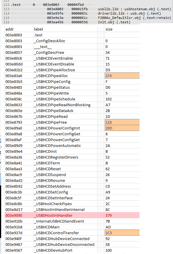

     I found out this from the map file :
    .text      0    003e8003    0000581e
                      003e8003    000015fb     usblib.lib : usbhostenum.obj (.text)
                      003e95fe    00000855                : usbdenum.obj (.text)
                      003e9e53    0000083c     driverlib.lib : usb.obj (.text)
                      003ea68f    0000061c     F2806x_DefaultIsr.obj (.text:retain)
                      003eacab    00000556     Init.obj (.text)
    Note that this was obtained when not trying to relocate to "run from ram". It seems the usbhostenum module is contained in the final .text section. However, I only use the library to communicate as a slave device on the usb port, not as a host. So I think this whole block should not be needed in my application.
    This would explain a fraction of the increase of the memory footprint. Do you have any idea why it is included ?
    I am not familiar with this library.  So I can only make general comments.
    The linker brings usbhostenum.obj in from the library because other code calls a function that is defined in that file. You can see the names of those functions later in the map file.  Look for the table that starts ...
    GLOBAL SYMBOLS: SORTED BY Symbol Address
    page  address   name
    Those functions are the symbols which are in the address range 0x003e8003 to 0x003e95fd.  If your code calls just one of those functions, then the entire file is brought into the link.  Is there one large function there?  Or many functions?  Are you sure none of those functions are ever called?
    Thanks and regards,
    -George
    From the map file :
    The USB0HostIntHandler() function is the biggest one and seems unused as I only need device mode and thus use USB0DeviceIntHandler() instead. As for the whole module, the direct calls seems not to include host functions but I will need much more manual research to verify if there is no function calls from anywhere in the fraction of the library I use.
    (Note that USBHostResume() is not in usbHostEnum.obj but in usb.obj even if its name contains "host")
    I think I will need to ask to someone familiar with the lib for this ... :/
    Thanks anyway and don't hesitate if you have any additional tips.
