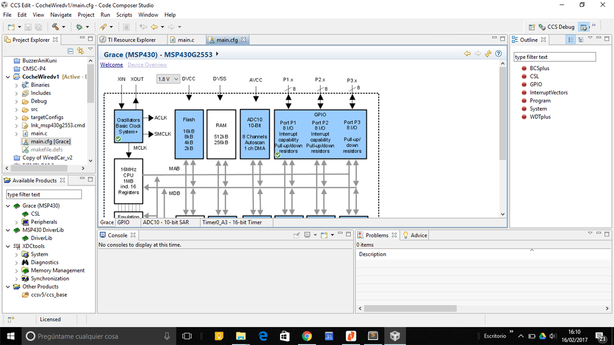

    And at least I have CCS5.5.0 with Grace installed 2 years ago (don't remember if I could have W8.1 when I did that installation) and it is the only CCS with Grace I can use:
  • Grace is no longer a supported feature in Code Composer Studio. That change occurred in CCSv6.1.
    If you have existing Grace projects and need to migrate them there is information here:
    processors.wiki.ti.com/.../CCSv7_Grace_Migration
    As far as the standalone version I just tried installing it on a Windows 10 machine. I get the same warning that you mentioned but it gave me the option to continue anyway. I continued with the installation and the product seems to work fine. The standalone version would have been released well prior to the release of Windows 10 so it will not recognize it during installation.
