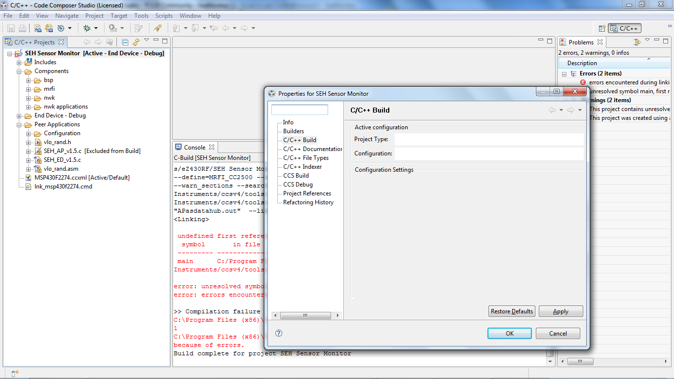

Hello, I've bought 2 eZ430 RS2500-SEH-development tools. I've installed all the programs (CCS v4, SLAC219 etc) in the included CD as described in the user guide pdf file: slau273.pdf. I've also upgraded the IDE to Version: 4.1.2.00027. Following the instructions at "4.1.1 Downloading Firmware to the MSP430", I tried to compile the firmware but I couldn't because the compiler reports some errors:
**** Build of configuration End Device - Debug for project SEH Sensor Monitor **** C:\Program Files (x86)\Texas Instruments\ccsv4\utils\gmake\gmake -k all 'Building target: APasdatahub.out' 'Invoking: Linker' "C:/Program Files (x86)/Texas Instruments/ccsv4/tools/compiler/msp430/bin/cl430" --cmd_file="C:/Texas Instruments/eZ430-RF2500-SEH_Sensor_Monitor-v1.5/CCE_Source/Projects/Examples/peer_applications/eZ430RF/SEH Sensor Monitor/Peer Applications/Configuration/smpl_nwk_config.dat" --cmd_file="C:/Texas Instruments/eZ430-RF2500-SEH_Sensor_Monitor-v1.5/CCE_Source/Projects/Examples/peer_applications/eZ430RF/SEH Sensor Monitor/Peer Applications/Configuration/End Device/smpl_config.dat" --define=MRFI_CC2500 --symdebug:dwarf --opt_level=0 --printf_support=full -z --reread_libs --warn_sections --search_path="C:/Program Files (x86)/Texas Instruments/ccsv4/tools/compiler/msp430/lib" --search_path="C:/Program Files (x86)/Texas Instruments/ccsv4/tools/compiler/msp430/include" --rom_model --heap_size=80 --stack_size=80 -o "APasdatahub.out" --library="rts430.lib" "../lnk_msp430f2274.cmd" undefined first referenced symbol in file --------- ---------------- main C:/Program Files (x86)/Texas Instruments/ccsv4/tools/compiler/msp430/lib/rts430.lib error: unresolved symbols remain error: errors encountered during linking; "APasdatahub.out" not built >> Compilation failure C:\Program Files (x86)\Texas Instruments\ccsv4\utils\gmake\gmake: *** [APasdatahub.out] Error 1 C:\Program Files (x86)\Texas Instruments\ccsv4\utils\gmake\gmake: Target `all' not remade because of errors. Build complete for project SEH Sensor Monitor
I've tried to solve the problem, also installing all the software in an other pc with Win XP (now I'm using Win 7 64 bit). Nothing changes, I obtain always the same error. I never had similar problems with other tools of TI's competitor and this is an incredible situation because not even the included firmware doesn't works. I was expecting a ready to use system from TI, but as I can see it's not the case. Can someone help me? Thank you in advance. Francesco

    Do you have a 'main' defined in your application? If not, you will need to specify the entry point of your application with the -e linker option. You can set this in the Build Properties (right-click on the project, select 'Build Properties' in the context menu, select 'C/C++ Build' in the left pane, select the 'Tool Settings' tab and under the Linker options mode, select 'Symbol Management' and see the option to Specify the program entry point.
  • Thank you Ki-Soo Lee, the firmware I'm trying to compile is the one included in the CD of the development tools. I never changed anything. Anyway please see the attached picture, as you can see there isn't the "Tool Settings" tab you suggested me to find. I can also attach the firmware in a zip file in a new reply.
  • There is a known issue with 64-bit windows where the GUI does not draw properly. See this video for a workaround:
    http://software-dl.ti.com/dsps/dsps_public_sw/sdo_ccstudio/CCSv4/Demos/ccsv4_ui_issue.htm

  • In your screenshot, I notice that CCS can't find the source files (the yellow exclamation mark). Do you have the source files? That could explain the linker error.
  • I just saw Aarti's reponse now. That could explain my previous post.
  • Thank you Aarti and Ki. Ok for the workaround. Now the GUI works properly. I've added "-e" but the compliation still stops saying "no input files". I opened the CCS workspace to this directory prior to importing your project: C:\Texas Instruments\eZ430-RF2500-SEH_Sensor_Monitor-v1.5\CCE_Source\Projects\Examples\peer_applications\eZ430RF as described to do in README.txt. I followed the instructions step by step. When I open the project for the first time I've an error message about the indexer. Please see the attached screenshot: as you can see some file are missing but I don't know where to find then because all I've installed comes from the CD of the demo. Thank you again. Francesco
  • The problem has been resolved. The compilation error was due to the lack of source files: they were not where they should be. Obviously the package installer could not write all the files correctly. Now the compilation gives no error. Thank you everybody. Francesco
