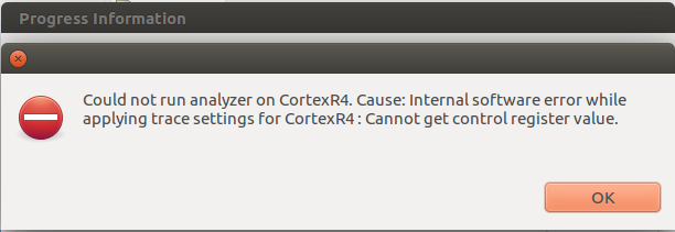

My custom board has TMS570LS2124 and i am trying to do trace (i.e. function profiling) with XDS560v2 Pro Trace.
I am using CCS 6.2.0.00050.
If i try to use ETB option in the Function Profiling, i get the following error:
"Could not run analyser on CortexR4. Cause:
Read device ID did not match with the device description available.
Possible reasons:
(1) Target is not connected
(2)Trace support for the device is not available in the version of the software."
When i select "Pro Trace" option in the Function Profiling following problem in the screenshots are obtained.
(1. screenshot is from Windows PC, 2. screenshot is from Ubuntu)
After the error occurs, i can not connect the device again, until a reset is done.
How can i solve my problem ?

  • Cagan,
    In order for us to have some additional insights on what may be happening, please provide the logs mentioned in section 9.2 of the page below:
    processors.wiki.ti.com/.../Troubleshooting_CCSv6
    Does this issue happen with a development kit as well? This would help us track this issue in a more timely fashion.

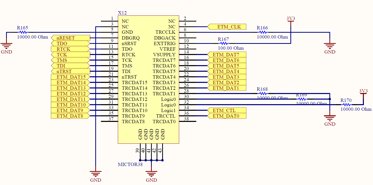

    3- Our custom board is different than SPRU655 because of space limitations. We are using 38-pin Mictor connector in our custom board. Below you can find the pinout of the custom board:
    And below is the pinout of the WORKING DEV KIT 60 pin connector. Basically we are not using all of the ETMDATA pins.
    Is it possible to trace our custom board with 38pin ? We can make some layout changes but it is impossible to carry the signals of full 60pin due to space limitation. Aren't we supposed to be able to trace with even 8bit ? Can you confirm that our board "should theoretically" work with the pinout i posted ?
    I will investigate the board in terms of skew and impedance aswell and soon post here about the values but in the document (i.e. page 29) it says not obeying the recommendations may reduce performance. Is there point, after which, i should expect these kind of error ?

  • Erman,
    Please apologize for the delay; I was out of the office most of this week.
    The Trace interface allows to use anything from 10 to 19 pins, therefore you should be fine with the number of pins being shown in your schematics. However, I noticed the trace pins are shifted in your schematics diagram: for example, the ETM_DAT15 is tied to nTRST, ETM_DAT7 tied to Vsupply, etc.

  • Hello Rafael,
    We managed to overcome the issue ! Well, we made an adapter PCB which equalized our routing lengths below the specifications in SPRU655I, Table23. Now it is working and i can do the trace.
    Erman
