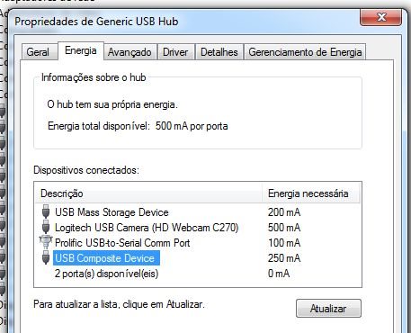

Going deeper into the USB hub information, I was able to confirm that the XDS200 is the "USB Composite Device" shown on the image below, and itself reports (at least when not able to connect) to require 250mA. The specs somewhere else say that it should be allowed 500mA, hence my "power based" suspicion.
Isn't that something that could be fixed with a driver update? Or maybe even with a firmware update into the debugger itself? Is this a realistic cause for the problem, to begin with? If not with new drivers and firmware, is there a workaround for this?
