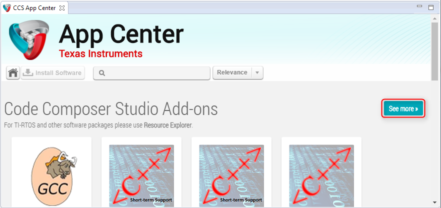

    Also, to ease the work of Linux/CDT development it is highly recommended to add this functionality to your copy of CCS. Simply go to the CCS App Center (menu View --> CCS App Center), locate the section Code Composer Studio Add-ons and click on See More.
    Then scroll down until you find both the Linux Development Tools and CDT GNU support
