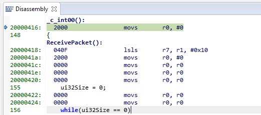

  • Ian Chiu said:
    I keep press F5 and program go to "0000040c: E7FEE7FE   udf  #0xee7e"
    Looking at the contents of TivaWare_C_Series-2.1.3.156\boot_loader\bl_startup_ccs.s the assembler function ProcessorInit is used to copy the code from flash to SRAM and then jumps to the code in SRAM.
    The disassembly screenshot shows the program counter in SRAM at address 0x20000416 but the code doesn't look valid. Has the ProcessorInit assembly function copied the code from flash to SRAM?
    Or if you refresh the disassembly view when _c_int00() is reached do the displayed instructions change?
    [I think the CCS disassembly view may cache some old data any may get confused after code is copied to SRAM by the running program]

    Hi Chester,
    Thank you very much!
    Q: Has the ProcessorInit assembly function copied the code from flash to SRAM?
    A: I'm not sure if it copied from flash to SRAM correct. However, if I let program "free run" and it work fine every time. (not in debug session)
     Q: if you refresh the disassembly view when _c_int00() is reached do the displayed instructions change?
    A: I tried. But it didn't change anything.
    But I got a good news!
    After I changed STACK_SIZE in bl_config.h form 48 to 1024.
    Everything I want to add in boot loader works perfect!!  :)
    But I still want to know how to debug bootloader :(
