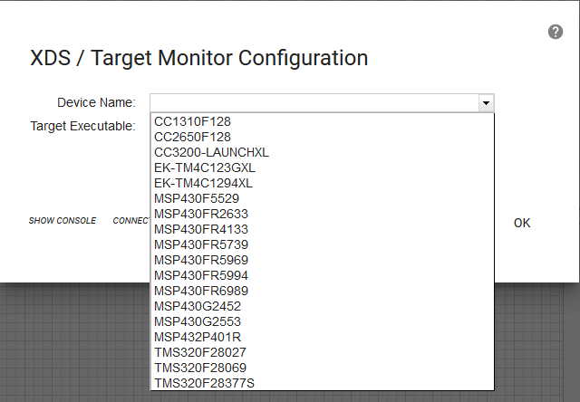

I'm using Concerto card to monitor power qualities and I want to show it in PC or web browser for mobile. GUI Composer V2 is very powerful tool but i don't know how to connect it with Concerto card via ethernet port.
Would it be possible to do that?
and does anyone have an example?

    GUI Composer v2 currently does not support Concerto or ethernet transport. I believe the Concerto support is coming soon but I'm not sure about ethernet. We currently have support for serial/UART and JTAG transport.

    Can I connect GUI Composer with Concerto via USB/Serial or XDS Debug port?
    and If it possible which device i must select when i config the GC project?
  • Tu,
    As I mentioned in my earlier reply, GUI Composer v2 currently does not have support for Concerto device (which is why it is not listed in the device drop-down).
    The support is expected to come in the near future but I don't have a definitive date at the moment. Sorry about the inconvenience.
