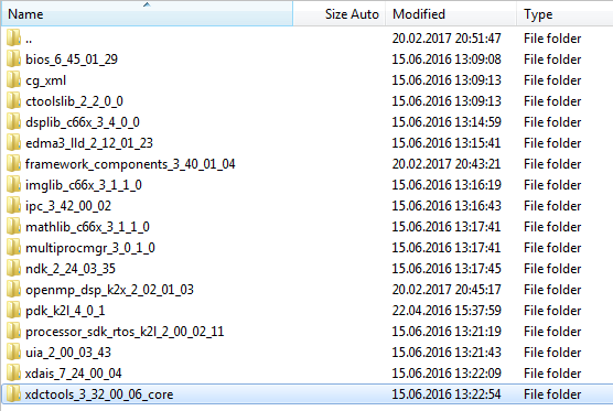

  • Shino,
    This part of the message explains what is happening:
    "C:/ti/xdctools_3_50_00_10_core/packages/xdc/tools/Cmdr.xs", line 52: Error: xdc.tools.configuro: Error: Can't find the platform package 'ti.platforms.evmTCI6630K2L'. TI platforms are no longer shipped as part of XDCtools (C:\ti\xdctools_3_50_00_10_core). Please ensure you are either using a pre-3.30 version of XDCtools or you have added a product that includes your platform support
    You will most probably have to change the XDC tools version of your project to the one shipped with the Processor SDK. If you are using the same version as I, the correct version is 3.32.00.06.
    Hope this helps,
