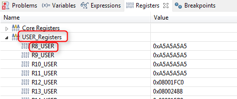

I'm using Hercules RM57Lx board and I have 2 problems:
1. I try to read User registers through DSS script by run the command long reg = debugSession.memory.readRegister("R8_USER"); but i get the following error: SEVERE: Register R8_USER not found. I can read any other core register.
    For non CORE registers, you would need to specify the group via <GROUP NAME>_<REGISTER NAME>.
    For example, to read the register R8_USER shown below:
    I would do something like:
    debugSession.memory.readRegister("USER_Registers_R8_USER");

  • thanks Ki,
    1. Now i manage to read the User registers. This is strange because to read the FIQ registers i didn't add the GROUP_NAME and the command reg = debugSession.memory.readRegister("R8_FIQ"); work well for me.
    Actually, I agree it is strange. That is because my previous comment was wrong. USER_Registers are indeed core registers. You should not have to prepend the core name like with the FIQ registers. I'm not sure what is happening. We are investigating this.
