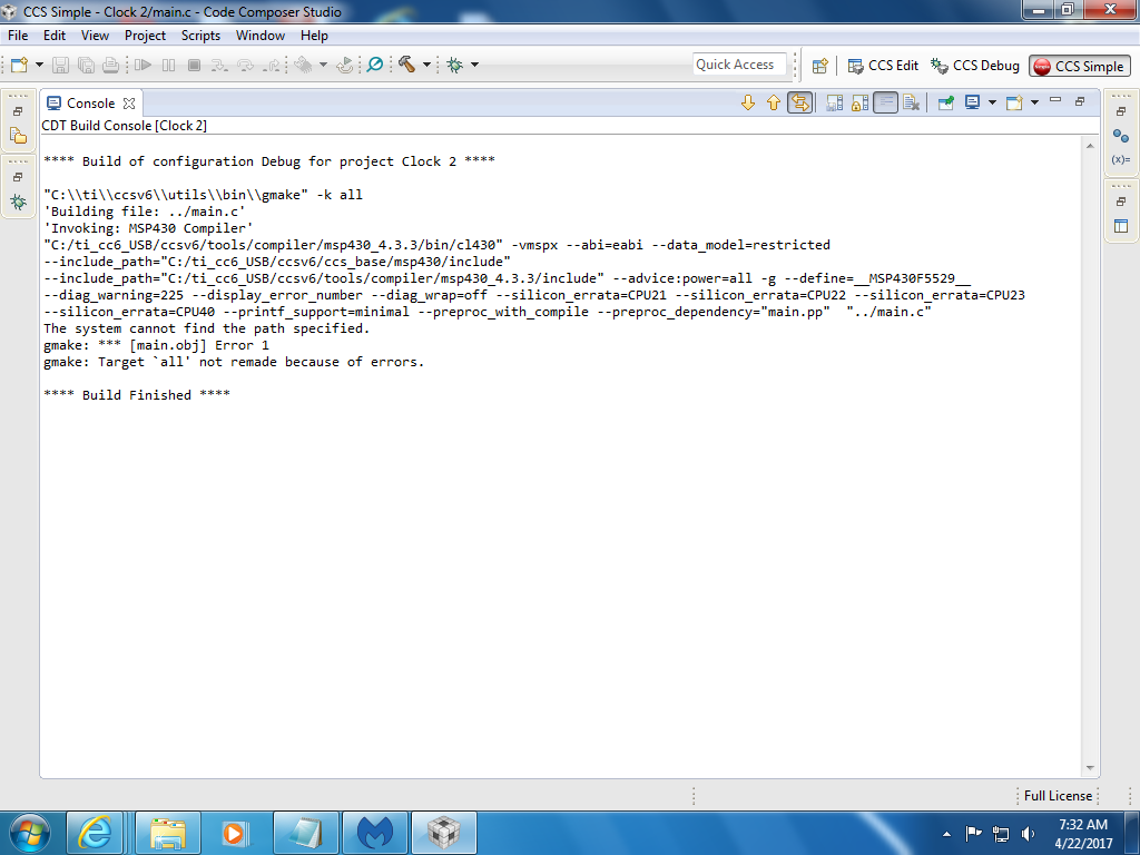

          I uninstalled the old compiler and re-installed the new compiler.   However, there is a problem.    The new compiler requires a "path" and I am not certain what path the compiler is referring to.   I am attaching a screenshot of the error message.   Can you please  tell me what path the compiler is referring to and how do I configure CCS6 and the compiler to see this path?
          Thank you, again for your technical support.
    From the screen shot it appears that CCS is installed in C:\ti (based upon the path of gmake), but that the makefile is attempting to access a compiler installed under C:\ti_cc6_USB (presumably the directory C:\ti_cc6_USB doesn't exist).
    By default CCS is supposed to automatically generate the makefile when performing a build, such that the makefile contains the correct path to the compiler (based upon the detected compiler).
    Can you check in the CCS project properties that "Generate Makefiles automatically" is ticked:
    Also, if you right-click on the project in the Project Explorer and select "Rebuild Project" to force a complete re-build of the project that might help.
  • Dear Chester;
    Thank you for your advice. Your answer got my system working. You are the greatest!!!
