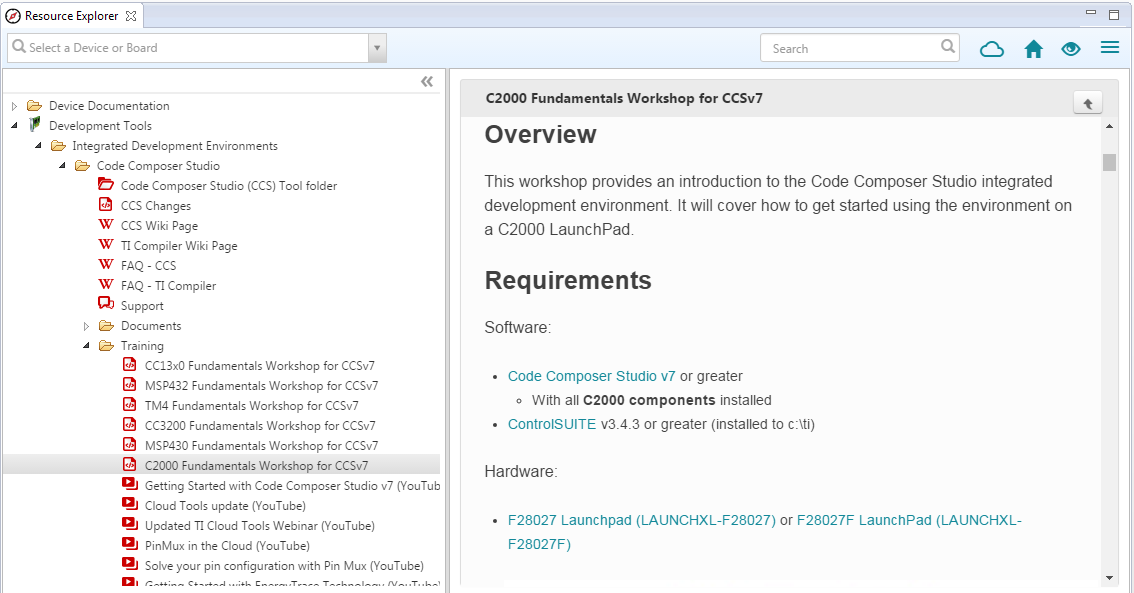

    If you are familiar with Eclipse then getting up to speed on CCSv7 should be pretty straight forward.  We do add our own build toolchain and plug-ins so there are differences.  We have some workshops to help with learning the environment.  They are accessible from within Resource Explorer. You can access Resource Explorer from the View menu and the shot below shows where the C2000 workshop is.
