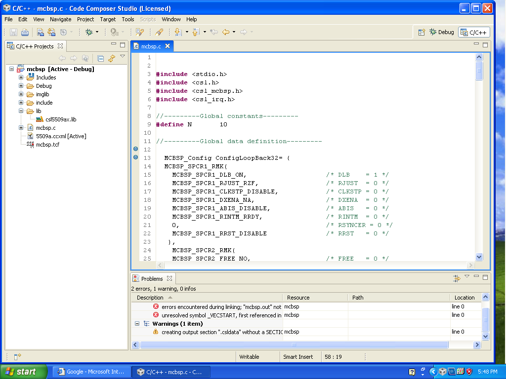

unresolved symbol _VECSTART
               I am using 5509A chip....  When i build, i am getting the following error...
Kindly guide me solve it?

  • Hi Pradeep,
    It looks like you are missing your vectors file that comes with CSL. Also it looks like you are mixing CSL and DSP/BIOS. Did you modify an example provided by us and added DSP/BIOS support?Do you need to use DSP/BIOS?
    When mixing pure CSL with DSP/BIOS you might need to do some adaptations when dealing with interrupts, the DSP/BIOS dispatcher can conflict with the CSL interrupt dispatcher. There is an article that gives examples for C6000 (not all information applies for C5000) that might help you:
    http://processors.wiki.ti.com/index.php?title=Converting_from_INTC_to_BIOS

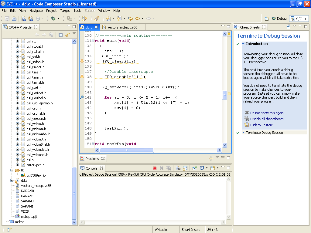

  • Hello Mariana,
                                Thank you so much... problem got solved..... I've done the following changes:
                                     * Created a new project without choosing DSP/BIOS
                                     *Included CSL5509ax.lib
                                     *Included Vectors_mcbsp1.s55 from mcbsp example
                                     *Included _IRQ_diableAll,_IRQ_clearAll in predefine symbols...
                             Now the code is free from errors, but i got the warning message for IRQ_diableAll, IRQ_clearAll .....
    Is IRQ_diableAll(), IRQ_clearAll() are predefined functions?.....
    Pradeep
  • I can not see the exact warning messages in the picture, can you post the warning messages for me to take a look?

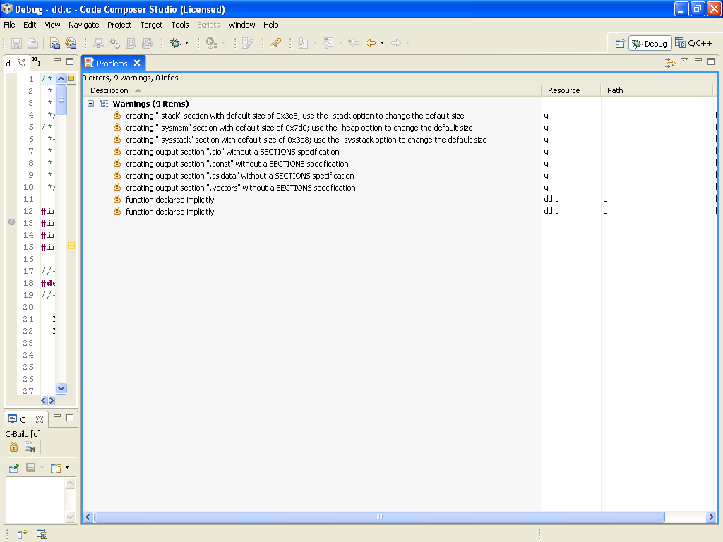

  • Warning i got:
  • Hi Pradeep,
    Do you have a linker command file (.cmd) in your project? Make sure that you include one, should be available with the CSL.
  • Thank you so much problem solved....
