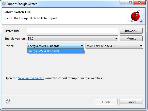

I'm trying to import energia sketch for CC1350 Launchpad but unfortunately device is not appear in the list. Only one device shows in the list Energia MSP430 Boards.

  • In Energia I'm getting all the board whichever I had downloaded but the problem is in CCS during the energia sketch import.
    See the attached image in my first post.  Only one board is appear in the list in spite of having all boards in Energia.

    Initially I saw the same as you.  Only the MSP430 boards were shown in CCS.  I installed CC13xx and I still only saw MSP430 in CCS.  I then went into the preferences in CCS and had it rediscover Energia and then it showed the new boards.  Thus it looks like you need to discover Energia if you change the board support.
    To do this I went to the import sketch dialog.  I then clicked the "More" button beside the Energia version.
    This takes me directly do the CCS preference page for discovering products.  I then click the "Rediscover" button to refresh.
    I then click ok and it takes me back to the previous dialog and the new board will be shown.
