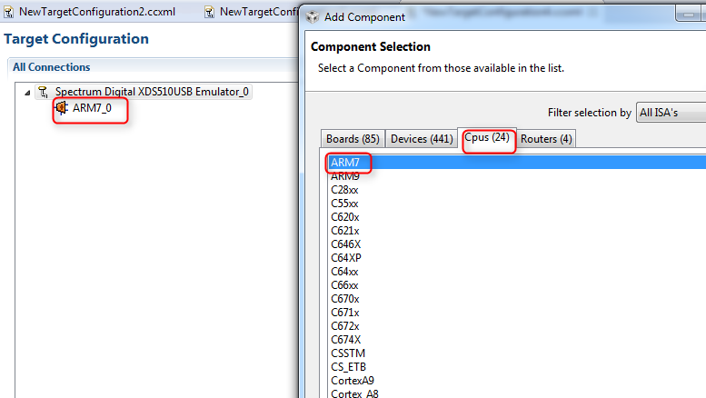

    Up to CCS Version 7, I saw it support TMS470MF******, but I did not see it support ARM7TDMI, such as TMS470R1x. What I have earlier CCS version 4,but I did not see it support ARM7TDMI. In CCS 7, I also did not see device selection for TMS470R1x, but only TMS470MF******. Please correct me if I miss understand something.
    CCSv7 does support TMS470R1x. However, you may need to create a custom configuration to use it:
    I recommend posting in the C5000 forum for recommendations on which CCS version would be best for your device. They will have the best recommendations.
