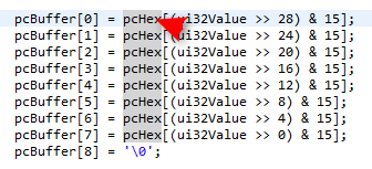

Which version of CCS are you running?
For me in CCSv7.1 if I put my cursor on the opening brace it puts a little box around the closing one.

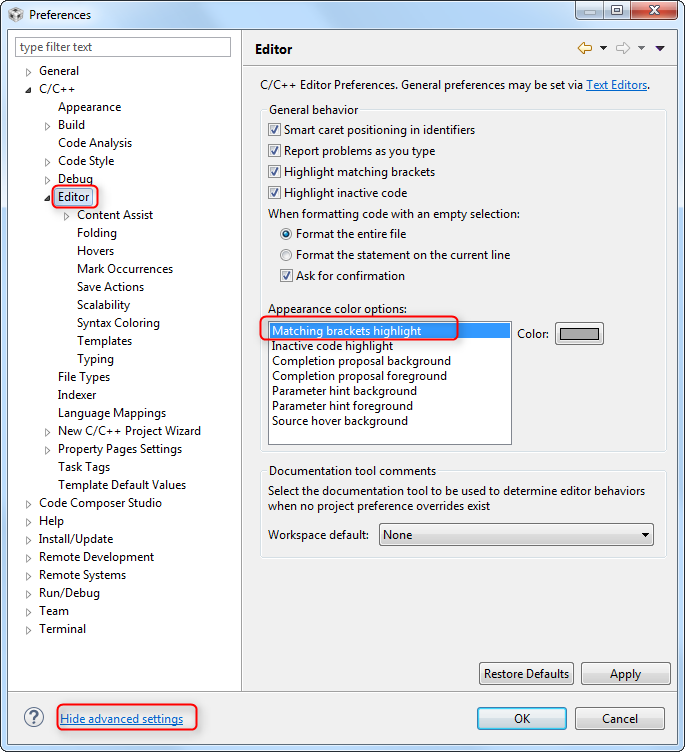

There is a preference setting for it. It is a bit hard to find via the preferences dialog. You can go to Window -> Preferences. Click on the link at the bottom left to show advanced options and then go to the spot indicated below.
A quicker way to get to that is to right click inside your source window and select preferences. That should take you directly there.
