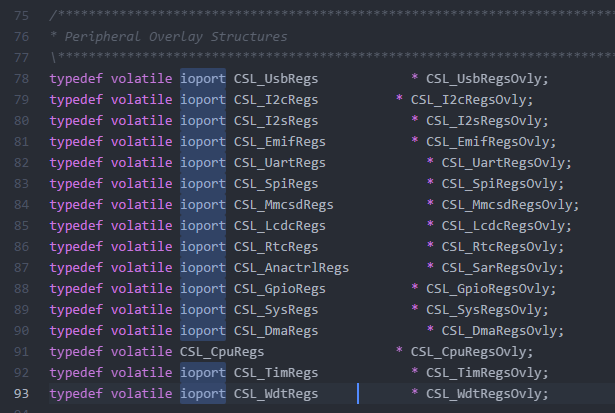

However this doesn't make sense to me because if I look through the CSL source, I can find the definition for CSL_DmaRegsOvly:
c55xx_csl/inc/soc.h has the typedef on line 90:
c55xx_csl/inc/cslr_dma.h contains the datastructure:

  • Okay, then dmaHandle->dmaRegs is of type CSL_DmaRegsOvly. Is dma_regs of the same type?
    I'm guessing CSL_DmaRegsOvly is a typedef of a struct type with no struct tag. Give it a name (at least for debugging the issue).
  • Correct, dma_reg is of the same type.
    Can you clarify what you mean by "give it a name"?
    Thanks!
  • I mean give the struct a struct tag:
    typedef struct I_need_a_name
    } CSL_DmaRegsOvly ;
