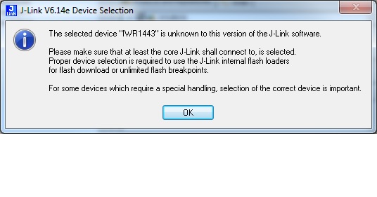

customer has a IWR1443 launchpad. He wants to connect it to the J-Link. He installed the Segger plug-in under CCS7. He gets following error message after trying to connect.

  • mmWave devices are not supported by Segger at this time. mmWave is very new so I am not aware of any plans to add this yet. Segger is pretty responsive to demand though. I will follow up with the mmWave and Segger teams. For now the customer will need to use an XDS probe. XDS110 would be the best low cost solution.

  • Supporting one Cortex R5 device is not the same as supporting all Cortex R4/R5 based devices. The debug IP can be different (ICEPick...), there will be additional items on the scan chain, there may be special startup sequences...
    Segger will validate that a device works properly before enabling it as a supported device.
