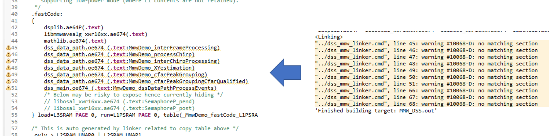

Hello everyone
I am using the C674x core on the AWR1642. In the attached CMD file, several functions are needed to be placed in some specific region on RAM. However, as showing in the following picture, the linker cannot find those function. And then i analysed the dss_data_path.oe674(I change the "obj" extension to oe674). I can see those MmwDemo_XXXXX functions in it, but the linker cannot. Can you tell me why?
The entire analysis output of the dss_data_path.0e674 file is in the attachment.
My enviornment is Windows 10, CCS 7.1.0016, compiler: TI V8.1.3
Peter

    .fastCode:
        dsplib.ae64P(.text)
        libmmwavealg_xwr16xx.ae674(.text)
        mathlib.ae674(.text)
        dss_data_path.oe674 (.text:MmwDemo_interFrameProcessing)
        dss_data_path.oe674 (.text:MmwDemo_processChirp)
        dss_data_path.oe674 (.text:MmwDemo_interChirpProcessing)
        dss_data_path.oe674 (.text:MmwDemo_XYestimation)
        dss_data_path.oe674 (.text:MmwDemo_cfarPeakGrouping)
        dss_data_path.oe674 (.text:MmwDemo_cfarPeakGroupingCfarQualified)
        dss_main.oe674 (.text:MmwDemo_dssDataPathProcessEvents)
        /* Below may be risky to expose hence currently hiding */
        // libosal_xwr16xx.ae674 (.text:SemaphoreP_pend)
        // libosal_xwr16xx.ae674 (.text:SemaphoreP_post)
    } load=L3SRAM PAGE 0, run=L1PSRAM PAGE 0, table(_MmwDemo_fastCode_L1PSRAM_copy_table, compression=off)

  • The object file dss_data_path.oe674 has no input sections named .text:MmwDemo_something .  It only has on large input section named .text.  You can see that from the listing of sections in the analysis file ...
     Section Information
        id name                      load addr  run addr      size align alloc
         0 (no name)                 0x00000000 0x00000000     0x0     0   N
         1 .text                     0x00000000 0x00000000  0x48c0    32   Y
         2 .l3data                   0x00000000 0x00000000 0xa0000     8   Y
         3 .l2data                   0x00000000 0x00000000  0xc000     8   Y
         4 .l1data                   0x00000000 0x00000000  0x4000     8   Y
         5 .switch:MmwDemo_EDMA_t... 0x00000000 0x00000000    0x30     4   Y
         6 .const:.string            0x00000000 0x00000000    0xbf     4   Y
         7 .c6xabi.attributes        0x00000000 0x00000000    0x44     0   N
         8 .symtab                   0x00000000 0x00000000  0x1690     0   N
         9 .rel.text                 0x00000000 0x00000000   0x4a0     0   N
        10 .rela.text                0x00000000 0x00000000   0x2e8     0   N
        11 .rel.switch:MmwDemo_ED... 0x00000000 0x00000000    0x60     0   N
        12 .TI.symbol.alias          0x00000000 0x00000000     0x9     0   N
        13 .TI.section.flags         0x00000000 0x00000000    0x1a     0   N
        14 .strtab                   0x00000000 0x00000000   0xf89     0   N
        15 .shstrtab                 0x00000000 0x00000000    0xfd     0   N
    The typical way to get subsections named .text:name_of_function is to build with the compiler switch --gen_func_subsections.  Please read more about that option in the C6000 compiler manual.
    Thanks and regards,
    -George
