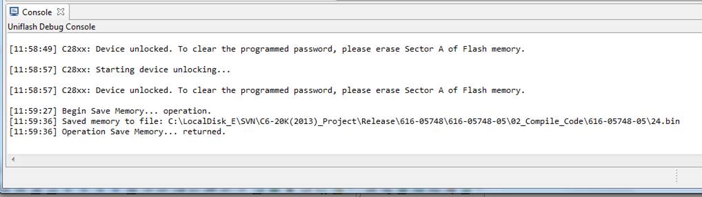

My customer is using UniFlash v3.4 and v4.1 for memory saving with F2809, and here is his question.
When CSM is disabled, he can save memory as .bin format successfully every time.
When CSM is enabled, after CSM is unlocked successfully, he got very little chance to save memory as .bin format correctly.
Most cases he got all 0's in the .bin output file, but he can confirmed that it did been unlocked.
Can anyone take a look at it and tell where's the problem?
