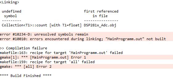

I am try to compile my template:
//ModBus.h
template <class T> class Collection
public:
static int count; //static declaration
Collection()
count++;
template<class T>
int Collection<T>::count;
//ModBus.cpp
#include "ModBus.h"
Collection<float> CollectionObject;
void ModBusTables_Init(void)
Collection<float>::count = 6;
I take compile msg
I found my situation on this page
http://processors.wiki.ti.com/index.php/C%2B%2B_Template_Instantiation_Issues
 on chapter called Third Workaround: Use a Template in a Non-Template Class Declaration.
The user who uses my template should declare himself every static member for each type he wants to use in template parametr? I do not like this
How can i solve this problem? Thank you!
