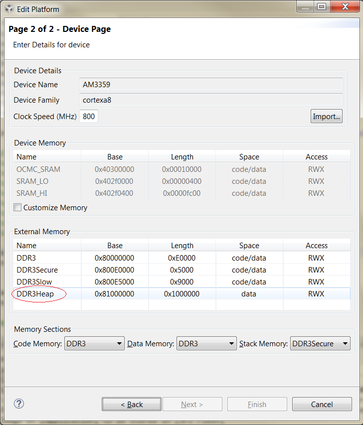

*To spy information i stock datas in a array allocated by a new() instruction (this size: 0x1000000 byte).
As you know, the new() instruction allocate object in the heap section.
*I create a plateform with multiples sections including a section for the heap : DDR3Heap section (0x81000000 at the end of the ram):
* In the am335x_app.cfg file I initialize the heap with the following instructions:
BIOS.heapSize = 0x1000000;
BIOS.heapSection = "systemHeap";
Program.sectMap["systemHeap"] = "DDR3Heap";
*You can see the result in the map file:
systemHeap     0x81000000  0x1000000 D:\Projects\Pilotage\6_Products\CNumDsp2015\src\AxisDriver\am335x_debug\configPkg\package\cfg\am335x_app_pa8fg.oa8fg
                0x81000000                ti_sysbios_heaps_HeapMem_Instance_State_0_buf__A
*My problem is that the size of the generated binary file (AxisDriver_SPI.bin) increase abnormally (34 Mb instead 900Kb).
After multiple trials, I find that this size depend of :
- the offset between the end of DDR3Slow and the start of DDR3Heap (0x81000000 - (0x800E5000+ 0x9000)).
- the size of the DDR3Heap section (0x1000000).
I use this file to program the Sitara, it's impossible to programm it, to slowww.
I don't understand why the heap configured in Data space (plateform window)  has an impact on the binary file.
Is there an option to force the linker to remove the DDr3Heap section from the linker mapping ?
Thank for your help.

  • After investigation the problem doesn't appear if I don't use sections in the Platform.
    With a single section : DDR3, it's ok. How is it possible to force the linker to ignore a datas section ?

  • I can explain a few things.  But I cannot, in the end, tell you how to fix your problem.
    jean-Michel Vignolles said:
    Ok for the "Hole" so, is it a normal comportment to include the .bss segment in a binary file ?
    If initialized sections are present on either side of it, then yes.  If all the initialized sections are before it, or after it, then it is effectively ignored.
    the binary file contains only the code to be programmed in the flash, no ?.
    Binary files are commonly used to program the flash.  But they do not contain only the initialized sections.
    If there is a hole in the memory map, between initialized sections, a binary file has exactly one method for representing that hole: fill it with 0.  One way such a hole may be introduced is for an uninitialized section, like .bss, to be placed in between initialized sections.
    Speaking in very general terms, the solution is to avoid (or minimize) the occurrence of holes in the memory map.  In the other thread I previously referred to, uses an elaborate technique to avoid a hole.  The problem initialized section gets allocated twice.  Once for load, and once for run.  The load allocation is next to all the other initialized sections.  The run allocation is where it needs to be for execution.  One of the steps taken at system start up is to copy this section from the load address to the run address.
    You need to do something similar.  I'm sorry, but I am not familiar enough with your system, or TI-RTOS, to give any specific advice.

    I have generated sections to isolate sensible safety code.
    I have supressed all the sections, it's ok now, sections cause the problem. For my nedd, an other way was to watch the integrity of the code with a CRC/hashtable.
