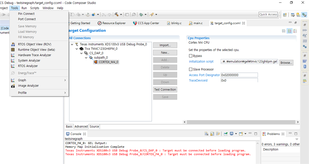

CCS/CCSTUDIO: Target must be connected before loading with TM4C123GH6PM
Part Number: CCSTUDIO
Other Parts Discussed in Thread: TM4C123GH6PM

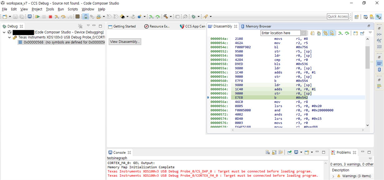

Hi, I created a custom perf board that uses TM4C123GH6PM, CCS 7.1, and XDS100v3 for 4 pins JTAG.
The following error appeared. I tried this Wiki's suggestion.

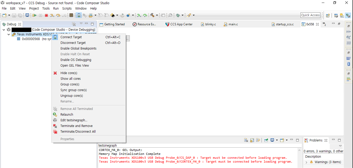

Although I clicked "Connect Target", nothing happened. I think it continuously runs an infinite loop.
At least, I think the debugger is connected to the TM4C MCU since it runs some assembly codes.
"In the CCS Debug perspective: "Tools -> Debugger Options -> Generic Debugger" and slect "Connect to Target on Debugger Setup"."
That alternative cannot be selected, either. In this case, what should I do to connect the target?
  • How are you starting up the debug session? Are you selecting the project in the Project Explorer view and clicking the "Debug"button. If so, the usual default behavior when doing this is to connect to target and load the program. If you are instead launching a target configuration file from the Target Configurations view, then the connection has to be done manually. More details about automatic and manual launch are in this page.
    If it is not connecting to the target in either way, then there is probably some other underlying hardware issue. Does the Test Connection come back ok?

    Whoa. I didn't expect this result.

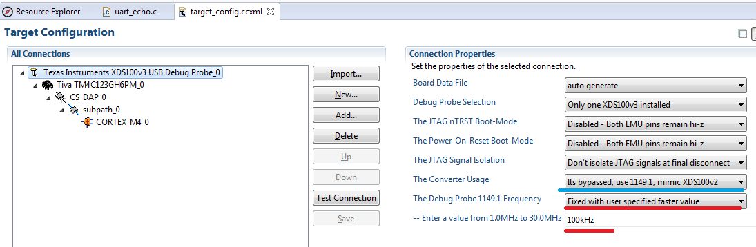

    This is strange. I'm using a 64-bit Windows 10 machine. I selected the XDS100 drivers while installing CCS 7 on this machine.
    As a result, "C:\ti\ccsv7\ccs_base\emulation\windows\xds100_drivers" has the proper files (amd64 folder which has DLL files, xds100bus, xds100port and more).
    Also, the "jioserdesusbv3.dll" is located at the "C:\ti\ccsv7\ccs_base\common\uscif" directory.

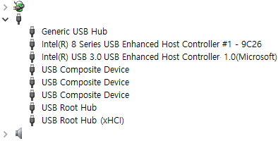

    This is the screenshot when looking at the "Device Manager".
    Although there wasn't the "XDS100v3" item in the USB section, it is found at another section called "Texas Instruments Debug Probes".
    I think the device driver and my JTAG connection, which uses pull-up and pull-down resistors, are correct.
    By the way, the version of my XDS100v3 is "XDS100v3 Revision B".
    Currently, jumper J4 and J5 are opened. I followed this instruction.
    They are responsible for the emulation – adapter configuration.
    When J4 and J5 are open – the chosen mode is emulator mode. When J4 an J5 are closed the chosen mode is adapter.
    For general use of the XDS100v3 as emulator and debugger, please, keep jumpers J4 and J5 open.

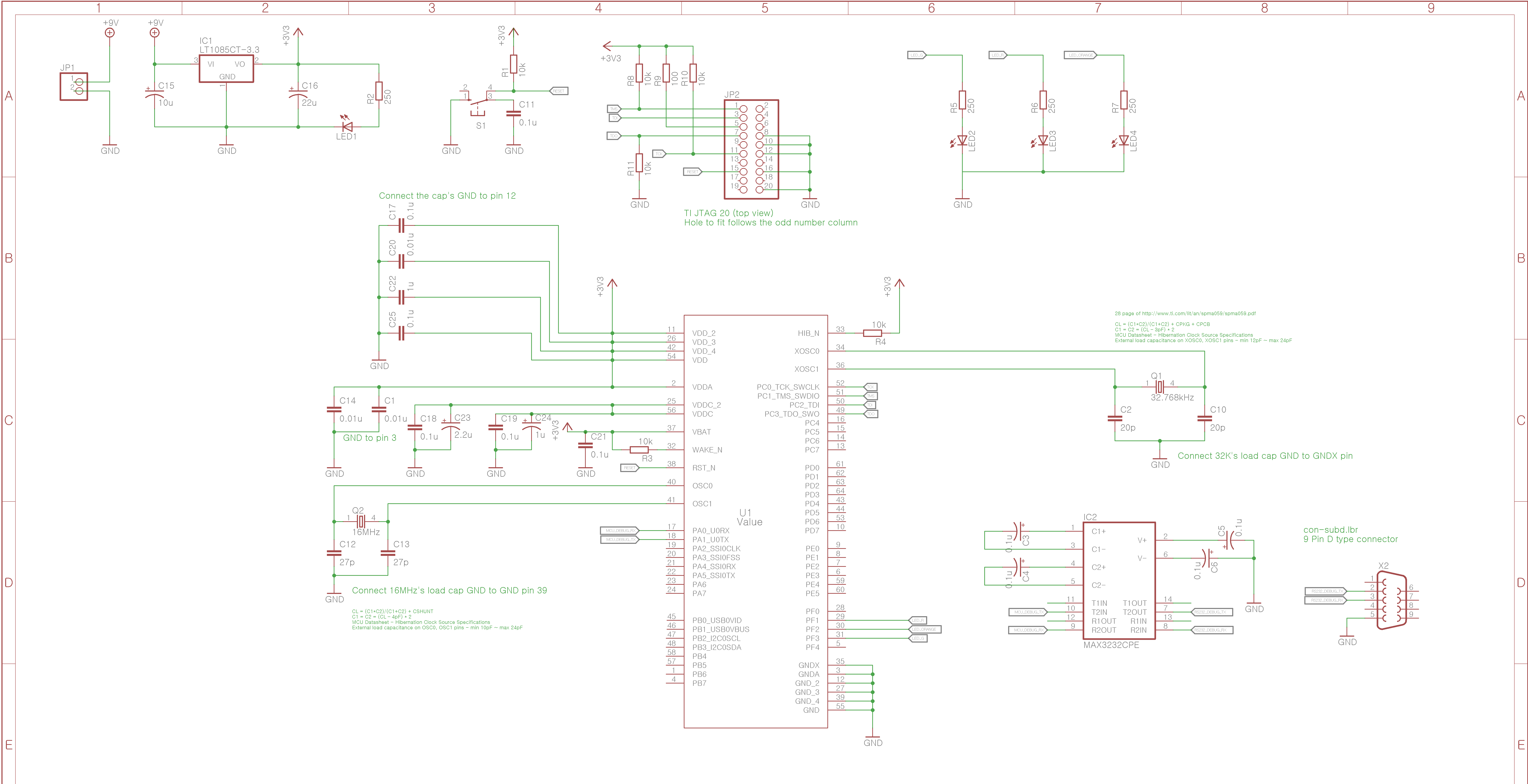

    Please share the JTAG schematics of your board. My concern is that there may be a pin(s) mismatch between the JTAG from the XDS100v3 and the header on the board.
    Secondly, in your original post it is mentioned "4-pin JTAG". What is 4-pin JTAG?
  • Hello, Amit. Here's the schematic of my custom perf board.
    Q1: 32.768kHz XTAL AB26TRB-32.768KHZ-T (±20ppm Crystal 12.5pF 50 kOhm)
    Q2: 16MHz TXC CORPORATION 9B-16.000MEEJ-B (±10ppm Crystal 18pF 30 Ohm)
    IC1: 3.3V regulator LT1085CT-3.3#PBF , the 9V battery is the input
    I wanted to express that I'm not using the ARM SWD to connect the MCU to the XDS100v3 and I use all 4 pins (TCK, TMS, TDI, and TDO).
    I also referred the "Sample Schematic for Compact TI 20-Pin Header" from here.
    Can you take a look at the wire connection, please?
    Is the "VBAT", "WAKE", or "HIB" pins configured correctly?

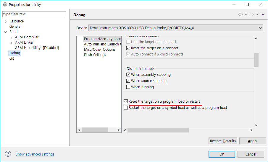

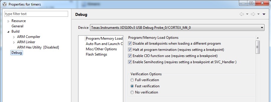

    Can you check the Project Properties under Debug -> Auto Run and Launch -> Launch Options to see if the "Connect to the target on debugger startup" option is ticked:
    If the "Connect to the target on debugger startup" option isn't ticked it will cause the Target must be connected before loading" error when starting a debug session.
    Given your test connection is failing not sure if the "Connect to the target on debugger startup" option not being ticked is the cause of errors when starting a debug session, but worth checking.
  • Hello David,
    The TDIS pin must be connected to GND. It is left NC in the schematic.
    Also when you connect the XDS100v3 probe, what does the PC device manager show?
  • Hi, Chester. Thanks for pointing that out. I was testing with the "blinky" example.
    Surprisingly, that wasn't checked. I have checked it now.
    Previously, there were 2 error messages.
    Now, only one message appears. Funny thing is that the code can be debugged!
    I have run the single line of codes and observed the LED blinking.
  • Thank you, Amit.
    Thanks for noticing this. I have connected it now. After connecting the TDIS pin, this is the result of the "test connection".

    Well, I think it showed some good news to me. I'm using the blinky example.
    I have changed the debugging configuration.
    Previously, two error messages showed up when I pressed the "Debug" button.
    Whereas, only one error message pops up, now.
    Funny thing is that the code can be debugged! I have run the single line of codes and observed the LED blinking.
    I cannot observe "XDS100v3" at the USB section.
    However, there was a section called "TI debug probes" and I can find the XDS100v3.
    Now, maybe one step is left to resolve that error message. Although the debugging is working, I want to solve that problem.
    Can you give me some help with this?
    There seems to be a quirk in CCS 7.1 that when a new target configuration is created for a XDS100v3 and a Tiva device the "Connect to the target on debugger startup" isn't checked by default for the CORTEX_M4_0 device.
    Whereas it is ticked by default when a new target configuration is created when a Stellaris In-Circuit Debug Interface is used.
    The remaining error is about connecting to the CS_DAP_0 device. If you check the debug project properties and select "CS_DAP_0" as the device is the "Auto connect if a child connects" option ticked?
    [I don't have a XDS100v3 so can't check the effect of the options for the CS_DAP_0 device]
    Nope. So I selected "CS_DAP_0" and clicked "OK".
    However, as you see this video, that menu returns back to "CORTEX_M4_0". Quite surprising.
    The version of my CCS is " Version: 7.1.0.00016 ".
    Well, the good news is that the debugging is working. So I just hope the TI team will check this "bug" in the near future.
    I deeply appreciate your time for helping me. Have a nice day!

  • Hello David.
    Can you change the parameter "The Debug Probe 1149.1 Frequency" from "Fixed default 1.0MHz" to "Fixed with user specified slower va;ue" and enter the value as 100KHz and then try to connect the device?
  • Hello, Amit.
    Like this?
    One weird thing is observed; compared to the "blinky" example when I import the "timers" example
    and change the configuration to use the XDS100v3 (but not setting the frequency to 100kHz), the error doesn't pop up
    even though it is configured to the "CORTEX_M4_0". I used a Windows 7 machine this time.
    Anyways, is that the configuration you've recommended? Or should I change the "Converter Usage" to "Generate 1149.7 4-pin standard mode"?

  • Hello, Amit. Only the "timers" example works as expected.
    When working with the "blinky" example, it does not work as expected.
    Then can we conclude that this is a bug created by CCS 7?
