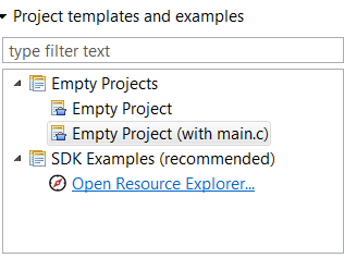

In part 4 of the series at around 4:30 it shows how to open an example project and how you can configure it and so on and so forth. When I open my version of ccs (7.1) I cannot configure or even open a new project in the way that is described there. The only thing I get is the following selection of project I can theoretically chose from.
I don't want to open the Resource explorer every time I want to start a new project and even if I wanted to, it doesn't give me the same functionality like it's shown in the workshop. I simply want to start a new project as shown in the series. Can anyone tell me how to do so?

  • Julien,
    Things have changed a bit since that workshop was created.  What device are you working with?  If you want to start with an example project but don't want to use Resource Explorer you can use the Project -> Import CCS Projects menu item.  You can then point to where the example projects are and import them.
    Based on the screen capture I am guessing that you are using a SimpleLink device, maybe MSP432 or CC2640...  for these devices there is something called SimpleLink Academy.  You can access it from Resource Explorer, either inside CCS or via dev.ti.com
