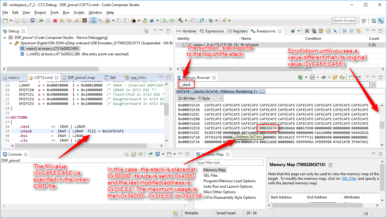

    The linker CMD file splits most sections across two memory regions (IRAM and L2RAM) to help overcome the increased memory usage. Some sections cannot be split (.stack, .sysmem, .cinit and .bss) but you can still leave the linker to choose where they will be allocated. (reference: here)
    The memory region I used (L2RAM) sometimes is used as Cache for the external SDRAM, thus the debugger does not allow writing to it - to allow writing to this, simply go to menu below and select ClearMemoryMap.
    If you plan to use the cache in the future, then replace L2RAM with EMIFCE0 on all memory sections.
    I also fill the .stack memory section with a known value to allow monitoring stack usage (see picture below). This has the drawback of increasing the size of the .out file, but has no impact in runtime and can be turned off when you finish debugging.
