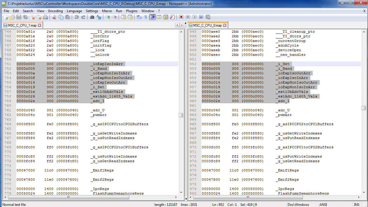

Hello there,
i have started to use the LAUNCHXL-F28379D.
The concept is to have all "IO things" on CPU1 while having all the algorithm on CPU2.
So the idea is to place all ADC results and all the other stuff in arrays which are then tied to global shared ram with a #pragma DATASECTION.
Of course the code in the main.cpp files of ech project are a bit different, but the #pragma DATASECTON´s are in the same order.
I have investgated the .map file and actually the arrays on the CPU´s don´t have the same order, see attachments at the bottom (mapfile, cmd files, pragma SECTIONS).
The projects are both running on optimization level -O2, have also tried the "off" condition with same result.
My question is how can i make sure the arrays are arranges equally on both CPU´s map files?
One idea could be to scramble the Global Shared RAM in chunks exactly the size of each array and define a name in the SECTION area of the map file. But this would mean some typing efford and more important a higher risk to forget something, whan an array gets changed in size...
Are there other approaches than that?
best regards,
Jasson

MEMORY

  • Please see this forum thread.  While the original question is not identical, it is close.  The answer is the same for your problem.
    Thanks and regards,
    -George
  • Hello Geroge,
    ok, i have read the thread you have linked.
    In a fast-try i tried my approach.
    I uncommented the predefined RAMGS2 area and defined two of my own, both of the size of 0x32 which is the space of 50 int16 types.
    I defined
    RAM_TEST_1 : origin = 0xE000, length = 0x32
    RAM_TEST_2 : origin = 0xE040, length = 0x32
    and in the SECTION area
    area1 .: > RAM_TEST_1, PAGE = 1
    area2 .: > RAM_TEST_2, PAGE = 1
    and in the c++ file i did
    #pragma DATASECTION("area1");
    int16 myArr1[50];
    #pragma DATASECTION("area2");
    int16 myArr2[50];
    Looking at the .map files this works. On both CPU´s the arrays are mapped to the same location.
    Is this a leagal way to go, or can it come to crashes during runtime for reasons i havn´t considered?
    Also, i noticed, that i needed to define the origin for RAM_TEST_2 to 0xE040, not 0xE032.
    Since 0x40 is dec.64 this doesn´t seem to be a cooincidence?
  • Unfortunately, you misunderstand the suggestion I made in the older forum thread.  The only way to control the order of data variables in memory is to define them not in C or C++, but in hand-coded assembly.  The details on doing that are given in that post.
    The technique you show is one way to put a specific variable at a specific address.  But it is cumbersome, and prone to error.  Imagine doing that for around 25 different variables.
    Thanks and regards,
    -George
