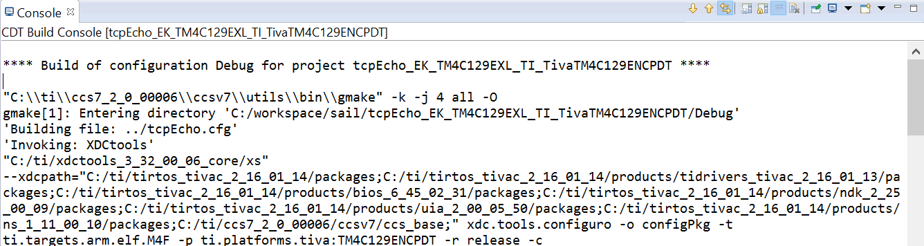

    **** Build of configuration Debug for project empty_EK_TM4C129EXL_TI_TivaTM4C129ENCPDT ****
    "C:\\ti\\ccsv6\\utils\\bin\\gmake" -k all
    'Building file: ../empty.cfg'
    'Invoking: XDCtools'

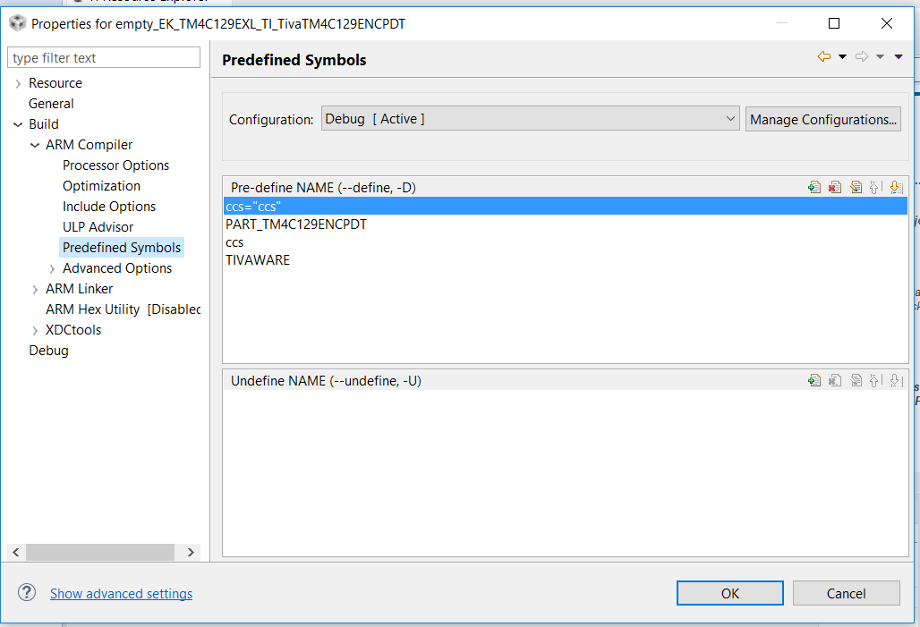

    "C:/ti/xdctools_3_31_00_24_core/xs" --xdcpath="C:/ti/tirtos_tivac_2_16_01_14/packages;C:/ti/tirtos_tivac_2_16_01_14/products/tidrivers_tivac_2_16_01_13/packages;C:/ti/tirtos_tivac_2_16_01_14/products/bios_6_45_02_31/packages;C:/ti/tirtos_tivac_2_16_01_14/products/ndk_2_25_00_09/packages;C:/ti/tirtos_tivac_2_16_01_14/products/uia_2_00_05_50/packages;C:/ti/tirtos_tivac_2_16_01_14/products/ns_1_11_00_10/packages;C:/ti/ccsv6/ccs_base;" xdc.tools.configuro -o configPkg -t ti.targets.arm.elf.M4F -p ti.platforms.tiva:TM4C129ENCPDT -r release -c "C:/ti/ccsv6/tools/compiler/ti-cgt-arm_17.3.0.STS" --compileOptions "-mv7M4 --code_state=16 --float_support=FPv4SPD16 -me --include_path=\"C:/ti/ccsv6/tools/compiler/ti-cgt-arm_17.3.0.STS/include\" --include_path=\"C:/Users/user1/Desktop/code composer/empty_EK_TM4C129EXL_TI_TivaTM4C129ENCPDT\" --include_path=\"C:/ti/tirtos_tivac_2_16_01_14/products/TivaWare_C_Series-2.1.1.71b\" --include_path=\"C:/ti/tirtos_tivac_2_16_01_14/products/bios_6_45_02_31/packages/ti/sysbios/posix\" --define=ccs=\"ccs\" --define=PART_TM4C129ENCPDT --define=ccs --define=TIVAWARE -g --gcc --diag_warning=225 --diag_warning=255 --diag_wrap=off --display_error_number --gen_func_subsections=on --abi=eabi  " "../empty.cfg"
