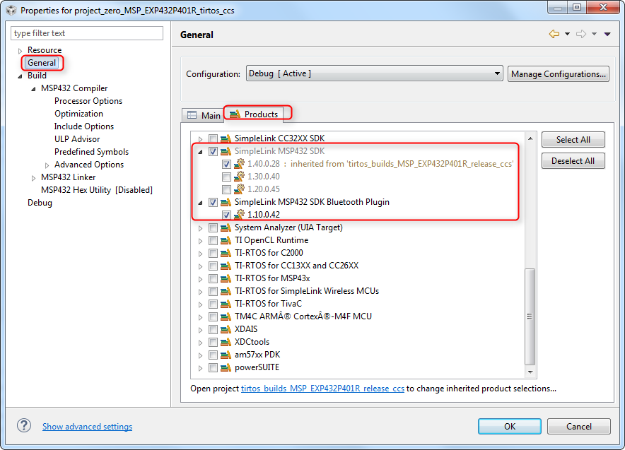

  • John,
    That variable gets automatically added to the project when you add the bluetooth plugin to the project.
    Here is the "project zero" project.  It has the products added to it for the SDK and the plugin:
    The SDK product is actually getting added to it from the "tirtos" project which is specified as a dependency, but the Bluetooth plugin product is specified directly in this project.
    Once you add that project it will setup the variables:
    I couldn't find the empty project but I imported the hello project from the TI-RTOS Kernel examples in the MSP432 SDK and added the bluetooth plugin and it built ok and the variable is there.  The screen capture is a bit different as the Products tab is called RTSC.

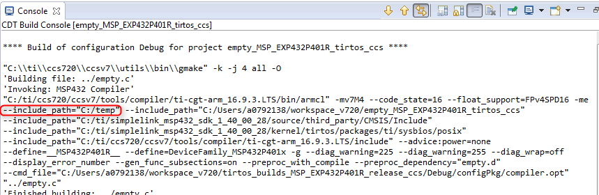

  • Jon,
    You can add the variable manually.  Not sure why you would want to if you are not using the plug-in but you can add it.
    Here I have imported the empty example and added that variable.  I set it to C:\temp so that it is clear that it is something that I set vs one that was automatically added.
    I clicked on the Add button in the dialog above
    I did this for both the CCS Compiler and GCC Compiler versions of the project.
    How are you attempting to set the variable?
    John

  • There are actually 2 types of variables in Eclipse. Build variables and linked resource variables. Typically you want the same variable available to both. The build variables are used in the compiler/linker options. The linked resource variables are used when you are referencing a file that you want to be part of your project but it is located outside the project directory.
    If you setup a build variable we made a change a couple years back to automatically add a matching linked resource variable. I don't believe it works the other way around.
