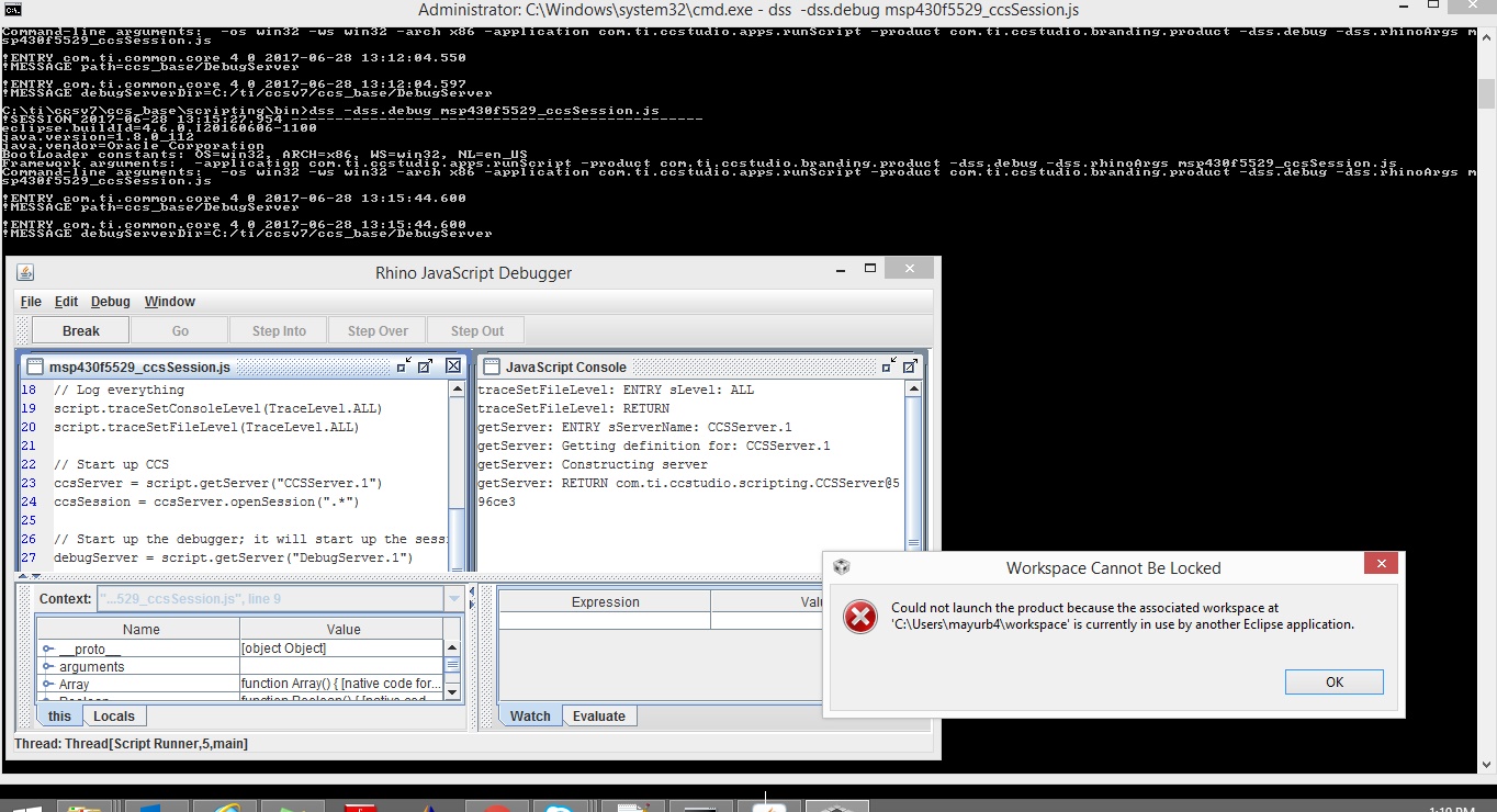

I am using CCSv7 studio. Using dss script i want to write the automation script.
But example provide to launch the CCS (msp430f5529_ccsSession ) itself not working showing the error for workspace.
I tried all the way but not able to open the CCS using dss. Kindly provide the solution for that.
if there is another method to open the ccs studio using dss let me know
This is a known issue that affects all CCSv7.x released (Tracking ID: CCDSK-2617)
It will be fixed in the upcoming CCS 7.3.0 release (September).
