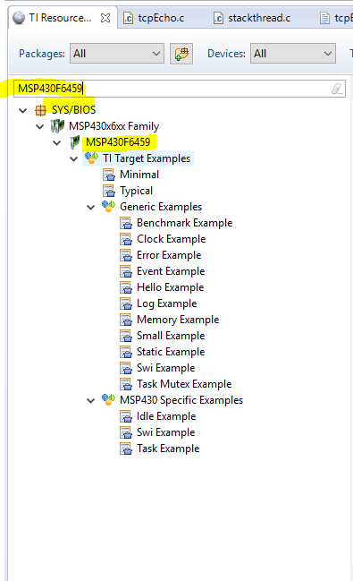

Hi.. Can you provide some examples related to above part number.... I didn't find any examples in CCS IDE relate to that particular part...
Is it support TI-RTOS?

Yes, the MSP430F6459 is supported by the TI-RTOS kernel. I'd recommend you get the latest version of TI-RTOS for MSP43x:
The MSP430F6459 device is not supported out of the box for the drivers (but it is for the kernel). There are instructions for building both driverlib (low level driver APIs) and the TI-RTOS drivers (OS-aware drivers that are built on driverlib) for MSP430 devices in the TI-RTOS User Guide.
If you don't need the drivers, you can just get the TI-RTOS kernel (SYS/BIOS):
. It has out of the box examples for all supported devices.
