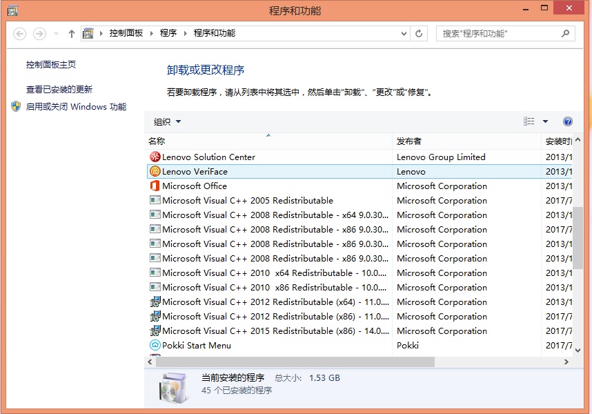

Dear Sir
We got problem during install the CCS 7.1.0.00016.
Our OS version: Windows 8.1.
According the log info "java.lang.UnsatisfiedLinkError: C:\ti\ccsv7\ccs_base\DebugServer\bin\LibraryLoader.dll: Can't find dependent libraries".
We refer this wiki and remove the MSVC Redistributables , the error remain.
So we reinstall OS. Install CCS 7.1.0.00016, the error still remain.
The picture below is the MSVC List during the installation CCS.
The error data as listed next.
Any one can help us fix this problem?

!ENTRY org.eclipse.core.jobs 4 2 2017-07-06 02:44:36.957!MESSAGE An internal error occurred during: "".!STACK 0java.lang.UnsatisfiedLinkError: C:\ti\ccsv7\ccs_base\DebugServer\bin\LibraryLoader.dll: Can't find dependent libraries at java.lang.ClassLoader$NativeLibrary.load(Native Method) at java.lang.ClassLoader.loadLibrary0(ClassLoader.java:1941) at java.lang.ClassLoader.loadLibrary(ClassLoader.java:1824) at java.lang.Runtime.load0(Runtime.java:809) at java.lang.System.load(System.java:1086) at com.ti.debug.engine.xpcom.Runtime.preXPCOMInit(Runtime.java:163) at com.ti.debug.engine.xpcom.Runtime.startBare(Runtime.java:116) at com.ti.debug.engine.xpcom.Runtime.createComponent(Runtime.java:170) at com.ti.utility.filesystem.DirectoryService.<init>(DirectoryService.java:26) at com.ti.utility.filesystem.DirectoryService.<init>(DirectoryService.java:9) at com.ti.utility.filesystem.DirectoryService$SingletonHolder.<clinit>(DirectoryService.java:44) at com.ti.utility.filesystem.DirectoryService.instance(DirectoryService.java:49) at com.ti.common.core.utils.ds.CoreUtilsProvider.getUserHomeDir(CoreUtilsProvider.java:40) at com.ti.common.core.CoreUtils.getUserHomeDir(CoreUtils.java:135) at com.ti.common.core.internal.ExternalReferenceParser.getUserExtRefDir(ExternalReferenceParser.java:176) at com.ti.common.core.internal.ExternalReferenceParser.getExtRefDirectories(ExternalReferenceParser.java:158) at com.ti.common.core.internal.ExternalReferenceParser.getReferenceFiles(ExternalReferenceParser.java:61) at com.ti.common.core.internal.ExternalReferenceParser.getReferenceFiles(ExternalReferenceParser.java:147) at com.ti.common.project.core.products.ProductDiscoveryManager.getProductDiscoveryPath(ProductDiscoveryManager.java:423) at com.ti.common.project.core.products.ProductDiscoveryManager.getProductDiscoverySearchPath(ProductDiscoveryManager.java:406) at com.ti.common.project.core.products.ProductDiscoveryManager.discoverDeclaredProducts(ProductDiscoveryManager.java:520) at com.ti.common.project.core.products.ProductDiscoveryManager.<init>(ProductDiscoveryManager.java:234) at com.ti.common.project.core.products.ProductDiscoveryManager.<clinit>(ProductDiscoveryManager.java:48) at com.ti.ccstudio.apps.internal.ide.CCSIDEInitializationParticipant.processProductDiscoveryPathArgument(CCSIDEInitializationParticipant.java:39) at com.ti.common.core.internal.headless.Initialize.run(Initialize.java:75) at com.ti.common.core.services.IDEInitializer.run(IDEInitializer.java:35) at com.ti.ccstudio.p2.actions.CCSInitAction$1.run(CCSInitAction.java:59) at org.eclipse.core.internal.jobs.Worker.run(Worker.java:55)!SESSION 2017-07-06 02:47:31.155 -----------------------------------------------eclipse.buildId=4.6.0.I20160606-1100java.version=1.8.0_112java.vendor=Oracle CorporationBootLoader constants: OS=win32, ARCH=x86, WS=win32, NL=zh_TWFramework arguments:  -application com.ti.ccstudio.p2app -repository file:/C:/CCS 7.1.0.00016_win32/baserepo/targetcontent_core_repo,file:/C:/CCS 7.1.0.00016_win32/featurerepo -installiu com.ti.targetcontent.feature.group,com.ti.ccstudio.launcher.win32.feature.group,com.ti.ccstudio.doc.win32.feature.group,com.ti.ccstudio.utils.cli.win32.feature.group,com.ti.ccstudio.targetdb.props.default.win32.feature.groupCommand-line arguments:  -os win32 -ws win32 -arch x86 -data C:/Users/CC/AppData/Local/Temp/ccs_bcd1b6ad-6c8b-429a-50ea-8c3666557bd4/workspace -application com.ti.ccstudio.p2app -repository file:/C:/CCS 7.1.0.00016_win32/baserepo/targetcontent_core_repo,file:/C:/CCS 7.1.0.00016_win32/featurerepo -installiu com.ti.targetcontent.feature.group,com.ti.ccstudio.launcher.win32.feature.group,com.ti.ccstudio.doc.win32.feature.group,com.ti.ccstudio.utils.cli.win32.feature.group,com.ti.ccstudio.targetdb.props.default.win32.feature.group
!ENTRY com.ti.common.core 4 0 2017-07-06 02:47:54.296!MESSAGE path=ccs_base/DebugServer
!ENTRY com.ti.common.core 4 0 2017-07-06 02:47:54.296!MESSAGE debugServerDir=C:/ti/ccsv7/ccs_base/DebugServer
!ENTRY org.eclipse.core.jobs 4 2 2017-07-06 02:47:54.343!MESSAGE An internal error occurred during: "".!STACK 0java.lang.UnsatisfiedLinkError: C:\ti\ccsv7\ccs_base\DebugServer\bin\LibraryLoader.dll: Can't find dependent libraries at java.lang.ClassLoader$NativeLibrary.load(Native Method) at java.lang.ClassLoader.loadLibrary0(ClassLoader.java:1941) at java.lang.ClassLoader.loadLibrary(ClassLoader.java:1824) at java.lang.Runtime.load0(Runtime.java:809) at java.lang.System.load(System.java:1086) at com.ti.debug.engine.xpcom.Runtime.preXPCOMInit(Runtime.java:163) at com.ti.debug.engine.xpcom.Runtime.startBare(Runtime.java:116) at com.ti.debug.engine.xpcom.Runtime.createComponent(Runtime.java:170) at com.ti.utility.filesystem.DirectoryService.<init>(DirectoryService.java:26) at com.ti.utility.filesystem.DirectoryService.<init>(DirectoryService.java:9) at com.ti.utility.filesystem.DirectoryService$SingletonHolder.<clinit>(DirectoryService.java:44) at com.ti.utility.filesystem.DirectoryService.instance(DirectoryService.java:49) at com.ti.common.core.utils.ds.CoreUtilsProvider.getUserHomeDir(CoreUtilsProvider.java:40) at com.ti.common.core.CoreUtils.getUserHomeDir(CoreUtils.java:135) at com.ti.common.core.internal.ExternalReferenceParser.getUserExtRefDir(ExternalReferenceParser.java:176) at com.ti.common.core.internal.ExternalReferenceParser.getExtRefDirectories(ExternalReferenceParser.java:158) at com.ti.common.core.internal.ExternalReferenceParser.getReferenceFiles(ExternalReferenceParser.java:61) at com.ti.common.core.internal.ExternalReferenceParser.getReferenceFiles(ExternalReferenceParser.java:147) at com.ti.common.project.core.products.ProductDiscoveryManager.getProductDiscoveryPath(ProductDiscoveryManager.java:423) at com.ti.common.project.core.products.ProductDiscoveryManager.getProductDiscoverySearchPath(ProductDiscoveryManager.java:406) at com.ti.common.project.core.products.ProductDiscoveryManager.discoverDeclaredProducts(ProductDiscoveryManager.java:520) at com.ti.common.project.core.products.ProductDiscoveryManager.<init>(ProductDiscoveryManager.java:234) at com.ti.common.project.core.products.ProductDiscoveryManager.<clinit>(ProductDiscoveryManager.java:48) at com.ti.ccstudio.apps.internal.ide.CCSIDEInitializationParticipant.processProductDiscoveryPathArgument(CCSIDEInitializationParticipant.java:39) at com.ti.common.core.internal.headless.Initialize.run(Initialize.java:75) at com.ti.common.core.services.IDEInitializer.run(IDEInitializer.java:35) at com.ti.ccstudio.p2.actions.CCSInitAction$1.run(CCSInitAction.java:59) at org.eclipse.core.internal.jobs.Worker.run(Worker.java:55)!SESSION 2017-07-06 02:48:08.035 -----------------------------------------------eclipse.buildId=4.6.0.I20160606-1100java.version=1.8.0_112java.vendor=Oracle CorporationBootLoader constants: OS=win32, ARCH=x86, WS=win32, NL=zh_TWFramework arguments:  -application com.ti.common.core.initialize -ccs.profileTag Installed Code Composer Studio 7.1.0.00016.Command-line arguments:  -os win32 -ws win32 -arch x86 -application com.ti.common.core.initialize -data C:/Users/CC/AppData/Local/Temp/ccs_bcd1b6ad-6c8b-429a-50ea-8c3666557bd4/workspace -ccs.profileTag Installed Code Composer Studio 7.1.0.00016.
!ENTRY com.ti.common.core 4 0 2017-07-06 02:48:11.535!MESSAGE path=ccs_base/DebugServer
!ENTRY com.ti.common.core 4 0 2017-07-06 02:48:11.535!MESSAGE debugServerDir=C:/ti/ccsv7/ccs_base/DebugServer
!ENTRY org.eclipse.osgi 4 0 2017-07-06 02:48:11.582!MESSAGE Application error!STACK 1java.lang.UnsatisfiedLinkError: C:\ti\ccsv7\ccs_base\DebugServer\bin\LibraryLoader.dll: Can't find dependent libraries at java.lang.ClassLoader$NativeLibrary.load(Native Method) at java.lang.ClassLoader.loadLibrary0(ClassLoader.java:1941) at java.lang.ClassLoader.loadLibrary(ClassLoader.java:1824) at java.lang.Runtime.load0(Runtime.java:809) at java.lang.System.load(System.java:1086) at com.ti.debug.engine.xpcom.Runtime.preXPCOMInit(Runtime.java:163) at com.ti.debug.engine.xpcom.Runtime.startBare(Runtime.java:116) at com.ti.debug.engine.xpcom.Runtime.createComponent(Runtime.java:170) at com.ti.utility.filesystem.DirectoryService.<init>(DirectoryService.java:26) at com.ti.utility.filesystem.DirectoryService.<init>(DirectoryService.java:9) at com.ti.utility.filesystem.DirectoryService$SingletonHolder.<clinit>(DirectoryService.java:44) at com.ti.utility.filesystem.DirectoryService.instance(DirectoryService.java:49) at com.ti.common.core.utils.ds.CoreUtilsProvider.getUserHomeDir(CoreUtilsProvider.java:40) at com.ti.common.core.CoreUtils.getUserHomeDir(CoreUtils.java:135) at com.ti.common.core.internal.ExternalReferenceParser.getUserExtRefDir(ExternalReferenceParser.java:176) at com.ti.common.core.internal.ExternalReferenceParser.getExtRefDirectories(ExternalReferenceParser.java:158) at com.ti.common.core.internal.ExternalReferenceParser.getReferenceFiles(ExternalReferenceParser.java:61) at com.ti.common.core.internal.ExternalReferenceParser.getReferenceFiles(ExternalReferenceParser.java:147) at com.ti.common.project.core.products.ProductDiscoveryManager.getProductDiscoveryPath(ProductDiscoveryManager.java:423) at com.ti.common.project.core.products.ProductDiscoveryManager.getProductDiscoverySearchPath(ProductDiscoveryManager.java:406) at com.ti.common.project.core.products.ProductDiscoveryManager.discoverDeclaredProducts(ProductDiscoveryManager.java:520) at com.ti.common.project.core.products.ProductDiscoveryManager.<init>(ProductDiscoveryManager.java:234) at com.ti.common.project.core.products.ProductDiscoveryManager.<clinit>(ProductDiscoveryManager.java:48) at com.ti.ccstudio.apps.internal.ide.CCSIDEInitializationParticipant.processProductDiscoveryPathArgument(CCSIDEInitializationParticipant.java:39) at com.ti.common.core.internal.headless.Initialize.run(Initialize.java:75) at com.ti.common.core.internal.headless.Initialize.start(Initialize.java:49) at org.eclipse.equinox.internal.app.EclipseAppHandle.run(EclipseAppHandle.java:196) at org.eclipse.core.runtime.internal.adaptor.EclipseAppLauncher.runApplication(EclipseAppLauncher.java:134) at org.eclipse.core.runtime.internal.adaptor.EclipseAppLauncher.start(EclipseAppLauncher.java:104) at org.eclipse.core.runtime.adaptor.EclipseStarter.run(EclipseStarter.java:388) at org.eclipse.core.runtime.adaptor.EclipseStarter.run(EclipseStarter.java:243) at sun.reflect.NativeMethodAccessorImpl.invoke0(Native Method) at sun.reflect.NativeMethodAccessorImpl.invoke(NativeMethodAccessorImpl.java:62) at sun.reflect.DelegatingMethodAccessorImpl.invoke(DelegatingMethodAccessorImpl.java:43) at java.lang.reflect.Method.invoke(Method.java:498) at org.eclipse.equinox.launcher.Main.invokeFramework(Main.java:673) at org.eclipse.equinox.launcher.Main.basicRun(Main.java:610) at org.eclipse.equinox.launcher.Main.run(Main.java:1519)
