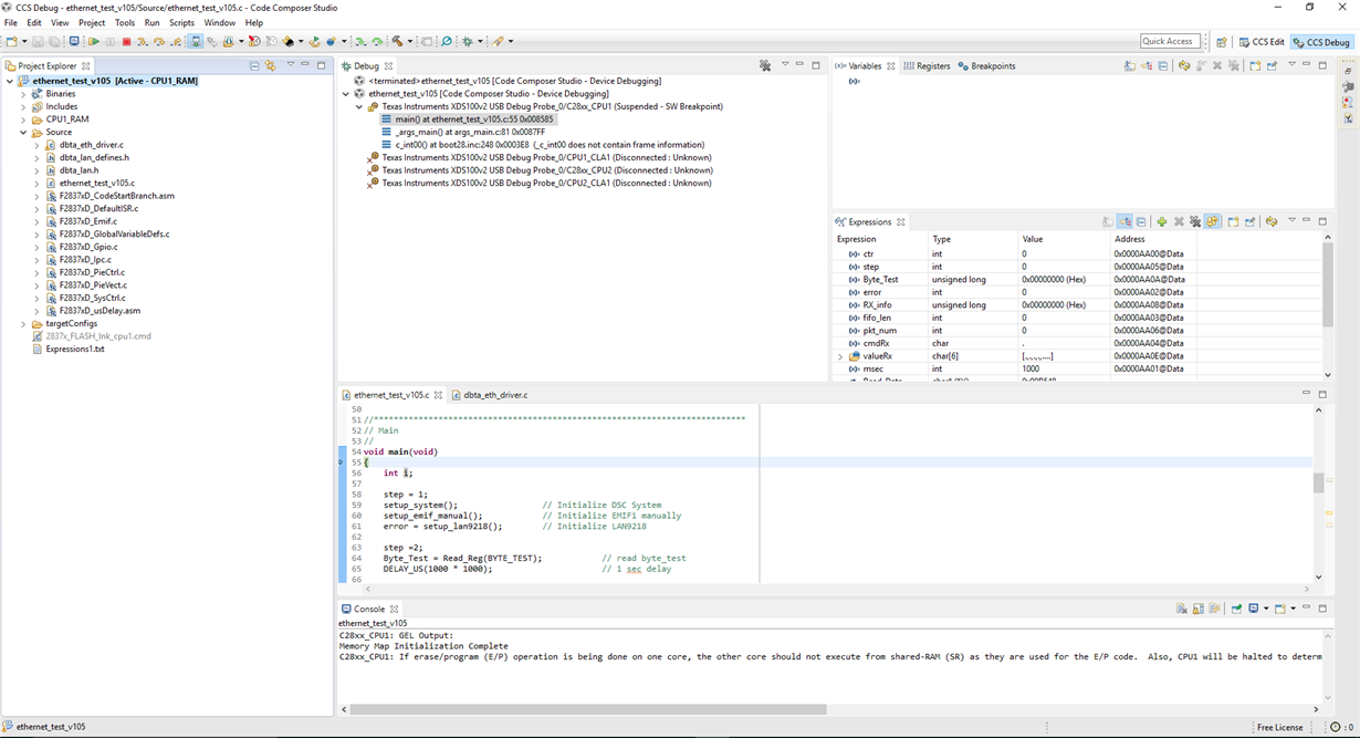

    Looking at your capture the callstack shows that you are halted somewhere inside the F2837xD_usDelay.asm file. You are not going to be able to see any local C variables when you are halted at this location.
    What happens if you set a breakpoint on line 58 in ethernet_test_v105.c, then reload the program and run? In general when you launch your debugger is it halting at main automatically?

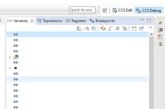

    When I launch the program it halts at MAIN automatically as shown below. But the Variables list does not show name or value, only (x)=
    The first picture from my last post showed the Variables list when I placed a breakpoint in my function "Read_Data".  When I did that I could add the local variables to the Expressions list.

  • I was able to make my variables view look like yours.
    Try the following to fix the variables view.
    Click the down arrow on the menu bar
    click on
    Layout-> show columns
    That should add the columns back
    John
  • That worked!
