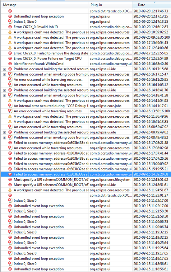

We have a very simple program and the following are the only tasks running. Just start STS, it will crash within 3 minutes. Thanks.

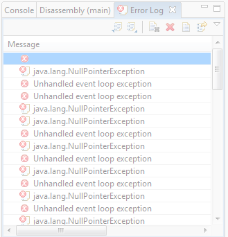

If you double click on the exception in the Error log, you should see an exception message and maybe some stack trace. Could you post the message here?

When you captured that screenshot of the Error log that you posted, are you still able to open the errors in that table?
If the GUI's unresponsive, you could try launching CCS with the -consolelog flag, and the error message may appear there. The easiest way to do this is to modify the properties of the CCS shortcut and add -consolelog to the end of the 'target' field on the 'shortcut' tab. If there are spaces in the path to the executable, then the path needs to be surrounded by quotes and -consolelog should be outside of the quotes.

After reproducing the crash, can you copy and paste the contents of the -consolelog as you did a couple posts back? Or is it not any different than what you posted there?
That very top exception in the error log is the one we need to look at, and the stack trace for it should show up in the -consolelog I think.
