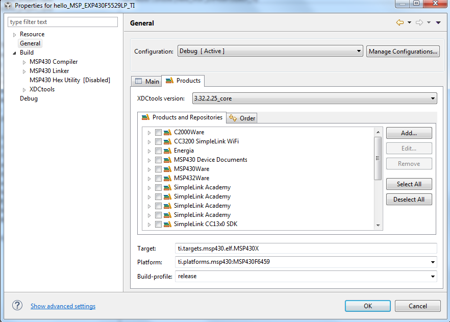

  • Florian,
    CCSv7.2 ships with both XDCTools 3.50 and 3.32.
    If you go into the properties for the project you can change it to use 3.32 instead of 3.50.
    Right click on the project and select properties
    Select General in the tree on the left
    Then on the right select the second tab which will either be called Products or RTSC.
    You can then use the drop down to change the XDCTools version
    John

  • Florian Delamare said:
    I am using CCS v7.2 on W7 with:
    Compiler TI v8.2.0
    XDC 3.50.2.20
    IPC 3.44.4.01
    SYS/BIOS 6.50.1.12
    UIA 2.20.0.02
    The are version conflicts in that:
    a) IPC 3.44.4.01 is in-compatible with XDCtools 3.50, but compatible with XDCtools 3.32
    b) SYS/BIOS 6.50.1.12 is compatible with XDCtools 3.50, but in-compatible with XDCtools 3.32
    Based upon the Component Version for Processor SDK RTOS Release Notes 03.03.00 suggest you need to use a combination of:
    XDCtools 3.32.x.x
    IPC 3.44.4.01
    SYS/BIOS 6.46.x.x
    The above is based upon a search for a Processor SDK version which included IPC 3.44.x.x, to see what were the compatible versions of SYS/BIOS and XDCtools.
    While the current latest Processor SDK version 04.00.00 includes a later IPC 3.46.0.2, the latest Processor SDK still uses SYS/BIOS 6.46 and XDCtools 3.32.
