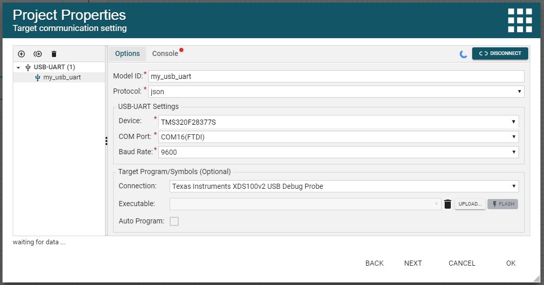

I am attempting to use GUI Composer v2 with my C2000 microprocessor . I have attached a screenshot of my Target Communication settings. When I click Connect, it gets to "waiting for data.." and does not get past that. I have the microprocessor connected to my computer via USB.

  • Do you have a program running on the F28377S sending data over UART? GUI Composer is waiting on data being sent over the COM port.
    There is a tutorial here that shows more on how the USB-UART model works:
    dev.ti.com/.../index.html
    That tutorial is for a different device but the concept is the same. You program sends data over the UART and then GUI Composer is configured to interpret and display it.
    If you are not sending data over UART then you may wish to look at the XDS model instead where GUI Composer will use the debug probe to read and write data.
