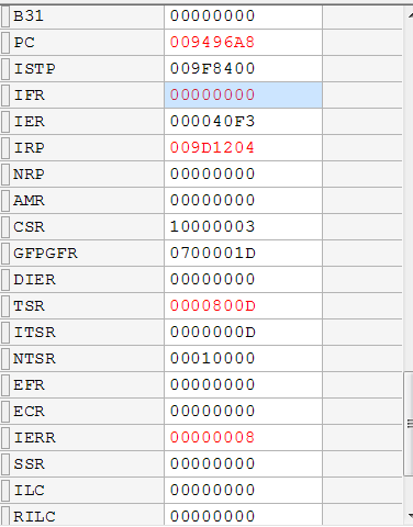

I am having a problem in which the program counter jumps to an address of a global variable instead to the address of the next function, Did anyone ran into this issue before?
This is what I get before
That suits to that function, which makes sene

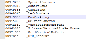

This is what I get when moving to the next line:
which suits to a global array
What can be the problem? Please help!
Keren

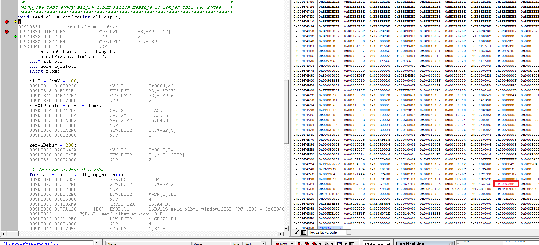

    I saved some screenshots of the program flow, including the memory data of the stack. I wanted to check whether the function return address is ran over, and it seems that it really is ran over. However, I don't understand the reason.
    The code section I am checking includes send_album_window --> PrepareWinHeader --> get_length functions flow.
    At first, getting inside send_album_window and saving the return address from that function:
    Then getting inside PrepareWinHeader and saving the return address from that function (we can see that the return address from send_album_window stays the same, located at the same memory address):

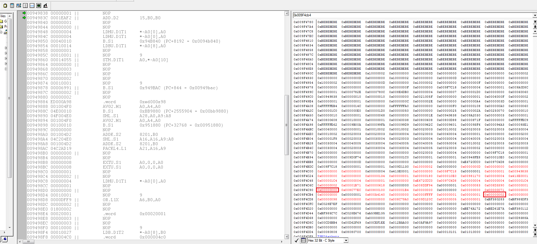

    Now we are just before getting inside get_length. That screenshot occurs a step before the running over:
    When getting out of the if-else inside PrepareWinHeader, can see that the address for returning from PrepareWinHeader is ran over(the return address from send_album_window stays the same, located at the same memory address):
    After that, moving step by step (F10), I finish the function and move right to the disassembly window (now the return address from send_album_window is changed too):
    After that I get an exception:

  • I think I am having a stack corruption by an Interrupt. I can see that the problem happens right after enabling the hardware interrupts. When I get inside the interrupt, right in the entrance of the interrupt, the memory is over written. Its very difficult to understand what caused the problem, does anyone has a working method how to find the problem?
    Thanks a lot,
    Keren
  • Keren,
    You are using CCS 3.3 which is very old and no longer supported. The compiler tools that came with that version of CCS are also very old so if the issue you are seeing is by any chance due to a compiler bug then there is not much we can do other than recommend that you upgrade to newer tools.
    Having said that, if you think this issue is due to a stack overflow, these pages might help point you in the right direction to help with debugging.
    http://processors.wiki.ti.com/index.php/Stack_and_Heap_size_requirements
    http://processors.wiki.ti.com/index.php/Checking_for_Stack_Overflow
