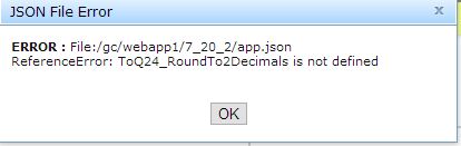

I have a GUI in GUI Composer that outputs motor speed values to a text box.  This text box utilizes an app.js function that converts the motor values into Q-24 format ("ToQ24_RoundTo2Decimals").  Everything was working fine, and then I started receiving the attached JSON file error and now the values are not converted properly.  For your reference, my project is titled "7_20_2" in the filepath.  What would cause the function not to be defined if it had been working before?
This error appears even if I switch pre-processing functions for the text box to something else besides "ToQ24_RoundTo2Decimals."

    Can you confirm that ToQ24_RoundTo2Decimals in the javascript file matches the one in the app.json file?
    ki
    I already posted my app.json, so I will now post my java script file.  There are other functions related to my GUI, but you can see near the top that the function name "ToQ24_RoundTo2Decimals" matches the name in the app.json file.  An important point to note is that even when I changed the binding to a different function (regardless of whether the function made logical sense as a pre-processing function) the same error appeared.

  • This issue was resolved offline. For those following the thread, the root cause was a syntax error elsewhere in the javascript which caused a ripple effect and led to a misleading error message.
