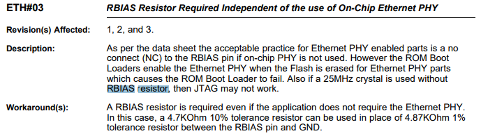

  • Ryan Erb said:
    We have a custom design that uses the TM4C1294NCPDT.
    Does the design have the RBIAS resistor fitted?
    If not, maybe you are being affected by the following errata:
  • Yes, RBIAS is there. See attached schematic.
