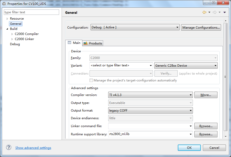

My customer is using CCSv7.2.0 with CGTv4.1.3 for F28035 project which is moved from early CCSv3.3.
They can build the whole project successfully but when they do an incremental build after "build all", they will get error of "missing separator" which refers to an extra "\" symbol in the end of line for included header file (see picture attached). Customer can manually remove the "\" and get the build succeeded but why this occurs? They don't have .d file in their source codes so this should be auto-generated.

  • Can the customer check all the places in the source code where CanIf_Cbk.h is included.
    Based upon the other threads you referenced, suspect the issue is caused by something like an extra space in one include of CanIf_Cbk.h.
    E.g. one of the source files might have something like the following (a space between the 'h' and " characters):
    #include "CanIf_Cbk.h "
    Interesting; a few days ago I saw the exact same issue and the root cause is identical to what was mentioned by Chester. The backslash in the .d listing file is, in fact, an escape <space> character or \0x20

    Customer did find "the extra space" between the 'h' and " characters.
    This issue was fixed and the post can be closed now.
