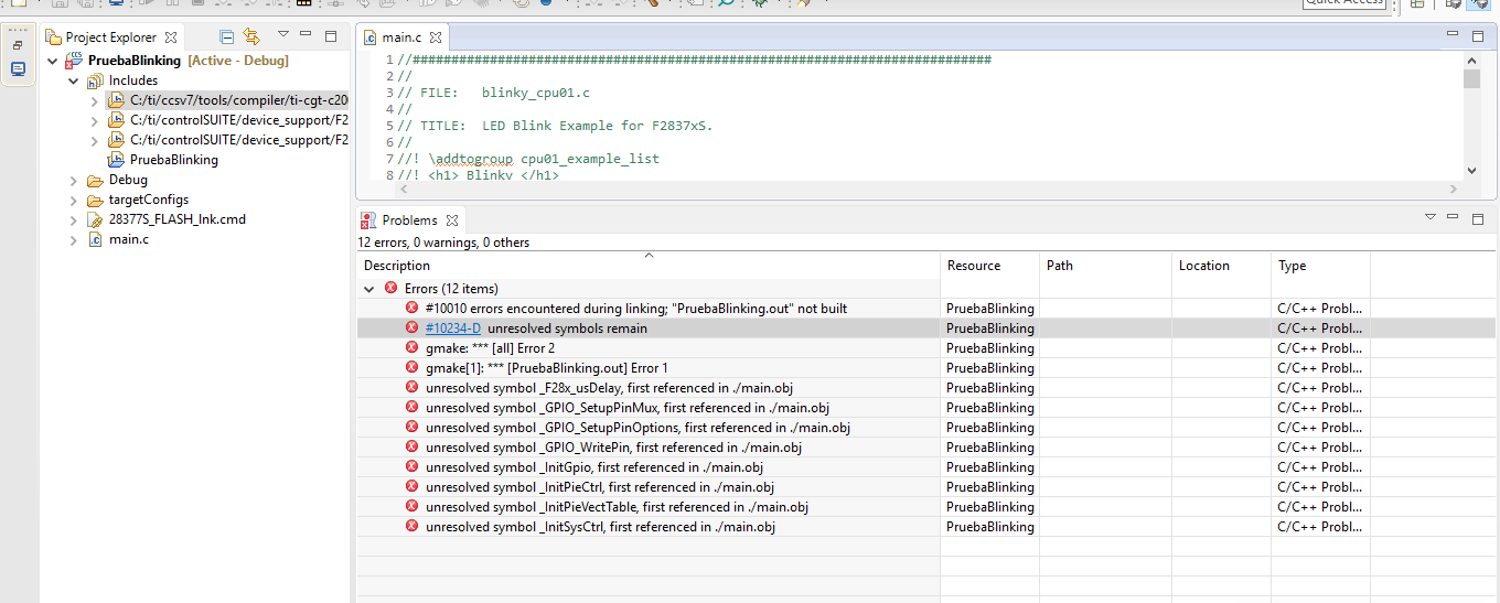

As you can the it need #include "F28x_Project.h"
So to include that header I go to. Proyect->Properties and in CCS Build->C2000 Compiler->Include Option and in Add dir to #include search path (--include_path, -l)
I include the paths:
C:\ti\controlSUITE\device_support\F2837xS\v210\F2837xS_headers\include
and
C:\ti\controlSUITE\device_support\F2837xS\v210\F2837xS_common\include
As you can see here
But when I press Build 'Debug' I get this error messages:

What I'm missing? an include? Please help me with this.
    You are getting a linker error, not a compiler error. Hence it is not an issue with include files or include search paths (which would lead to compiler errors).
    The linker you are getting is described below:
    http://processors.wiki.ti.com/index.php/Compiler/diagnostic_messages/10234
    In your case, you are missing library or source files that define the symbols mentioned. For example:

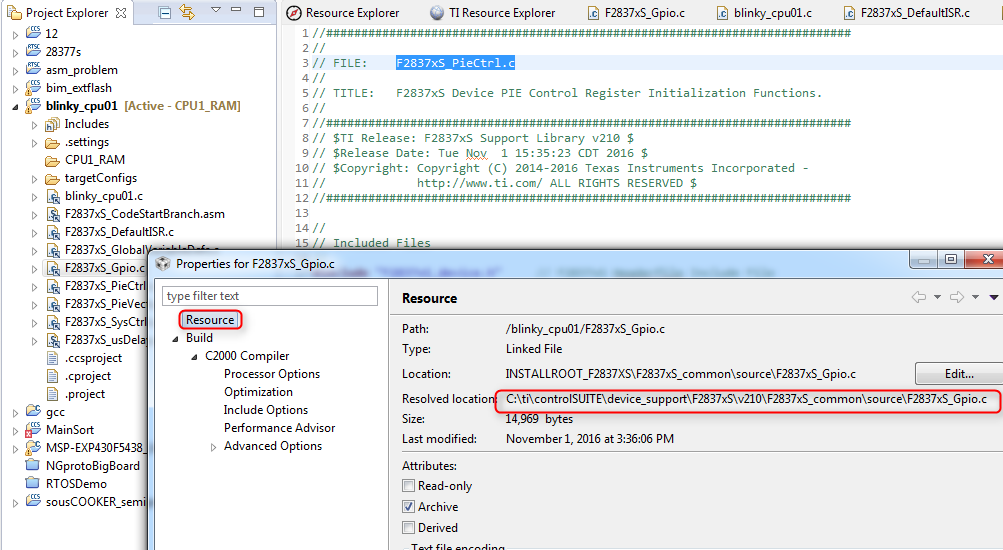

    Where are F2837xS_Gpio.c and F2837xS_PieCtrl.c? I can't find it in C:\ti\controlSUITE\device_support\F2837xS\v210\F2837xS_examples_Cpu1\blinky\cpu01
    and How I must include a .c? I think it's different that a .h in eclipse.
    Import the project into your workspace. When it is imported, you can see the project with several linked files. A link means that the file is not inside the project folder but the project has the path to it. That is why you don't see the source file there. You can right click on each linked file and in the properties you can see where it is located:
    Add it to your project like any other source file (like main.c)
