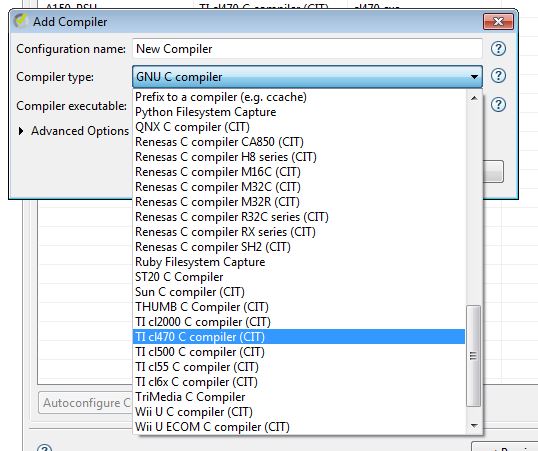

We need to use Coverity for static analysis for source codes. The compiler version of TI which Coverity supports is shown below(TI cl470)
However, the compiler version I am using currently is cl430 (MSP430 TI C Compiller V4.3.3). Besides, it seems that there is no cl470 available from “Available Software” in CCS
Does anyone know where can I download this cl470? And does this cl470 means the V4.7.0 version?
I don't recognize that screen shot. I presume that is Coverity.
Around 5 years ago, the TI ARM compiler changed the name of the compiler shell from cl470 to armcl. It appears this implementation of Coverity has not been updated to account for this change.
