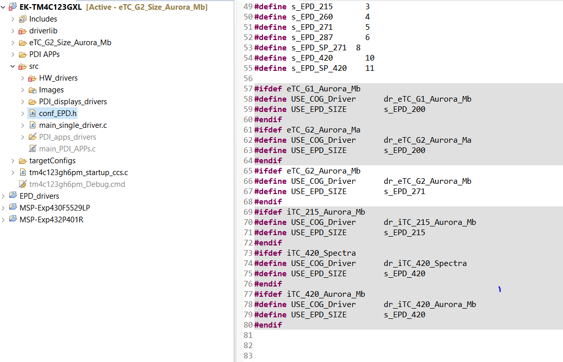

I am working with EK-TM4C123GXL and pervasive gen2 development board. I am getting errors in driverlib.h as well as the (.ccxml) file.
The following images better describe this situation. Please let me know what I am doing wrong.
    You mentioned you are using a Tiva device (TM4C123), hence your screenshots are confusing to me. In your first and second screenshot, you selected the TI MSP430 USB connection type. This connection type does not apply to Tiva. The third screenshot has you selecting a connection type for the onboard parallel port debug probe on a 2812 ezdsp, and again, nothing to do with Tiva

    Sorry for the confusion. When I took the screenshot it was the wrong connection type. I am using the Stellaris In-circuit Debug Interface (ICDI) with this Tiva C series LaunchPad. In the third image the error actually reads "The connection Sellaris ICDI does not contain any processors" when trying to debug.
    What I am trying to figure out is why there are errors in driverlib.h as well as the (.ccxml) file.

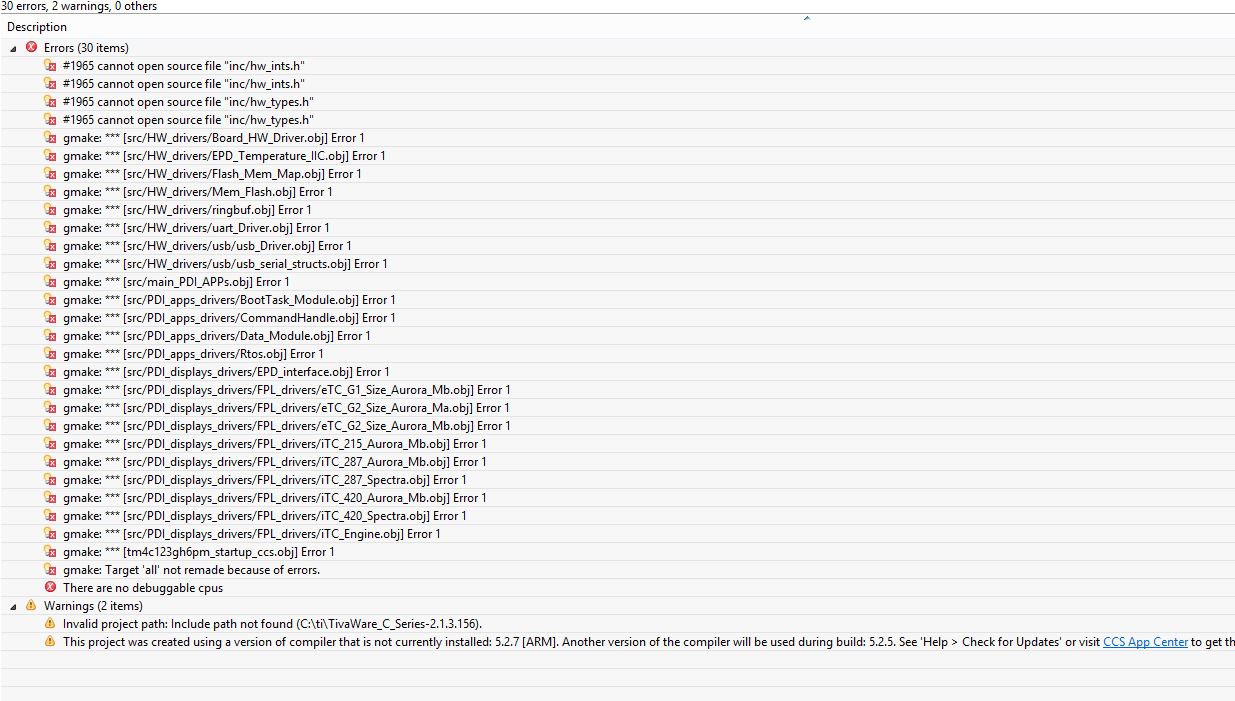

    Please provide the exact error messages.

    Please see image below with all error messages. The ccxml file cannot be attached here due to error message but you can download it from this website by going to support platforms tab: http://www.pervasivedisplays.com/kits/ext2_kit
  • I downloaded the firmware code package. It is mostly a workspace folder with some project associated to it. I switched my CCS to use that workspace. Then I simply build the EK-TM4C123GXL project in there. It build fine and I was able to connect to by launchpad and load the code.
    I basically followed the steps in the User's Guide: www.pervasivedisplays.com/LiteratureRetrieve.aspx?ID=241025
    There are some dependencies however and I suspect you are missing them, especially when looking at you screenshot. This project requires an installation of TivaWare v2.1.3.156 at "C:\ti\TivaWare_C_Series-2.1.3.156". Note the first warning in your screenshot. If you don't have it installed in that location, the build will fail similar to what to what you see. Check the User's Guide again and make sure you have all the dependencies installed.
    Note that you can have a later version of TivaWare. You will just need to modify the project properties to adjust for that (see User's Guide).
