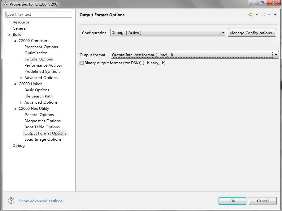

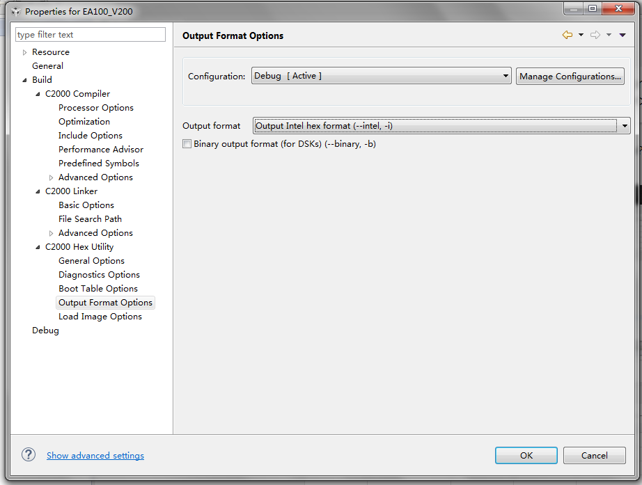

I use these versions of CCS to generate the hex file will exist some errors, while the initial ccs6 has less problem.
when I prohibit the generation of HEX file will have on errors.
the configurations are as below:
1.Output format :output intel hex format
2.Specify rom width:16
